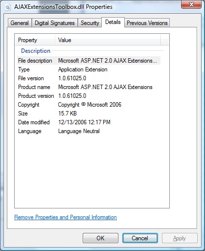

Thanks for your help so far junges and sjors1309!
Yes, I installed AJAX and added it as a reference. Also, "AJAXExtensionsToolbox.dll" can be found in the BIN folder.
Also, the application compiles without any issue. only when opening the page do I recieve the "SYS" error.
Also, I created an app where I used an UpdatePanel which worked fine but when I tryed to add AJAX to an existing app is where I ran into problems. I looked for some time to find the difference in the 2 apps where I thought the issue could be without success.

by: MarcGraffPosted on 2008-06-01 at 08:49:55ID: 21687478
1. Never thought of that. I went into the "bin" directory of my app and it is the dll for version 2.0.
2. I am using my local box. So no, there is no publicaiton yet.
by: sjors1309Posted on 2008-06-01 at 11:18:52ID: 21687910
Please check in Solution Explorer the Property Pages for your project. You should get al listing of your references and a Target Framework setting (in category 'Build')
by: MarcGraffPosted on 2008-06-01 at 12:10:30ID: 21688084
The framework is 2.0 and the AJAXExtentionsToolbox is present.
by: sjors1309Posted on 2008-06-01 at 12:25:10ID: 21688148
I'm wondering about System.Web.Extension. This is the primary Ajax Extensions DLL. This is what the toolbox uses. It should be referenced for it's that assembly that contains the base constructs for Ajax. Sys being one of them.
I really think you should investigate in this direction.
by: jungesPosted on 2008-06-02 at 05:42:27ID: 21691423
are you doing some redirections on you Global.asax ?
by: MarcGraffPosted on 2008-06-02 at 08:15:06ID: 21692728
I have a procedure that runs and checks for an active DB session. if is fails, it redirects. I comented everything out in the subs of global.asax.vb but the issue remains.
by: MarcGraffPosted on 2008-06-02 at 08:52:06ID: 21693076
sjors1309, I am not sure where to look. I have added it into my web.config as an assembly and in several other places as you can see from my web.config. I also tried registering at the page level with this without success:
<%@ Register Assembly="System.Web.Extensions, Version=1.0.61025.0, Culture=neutral, PublicKeyToken=31bf3856ad364e35" Namespace="System.Web.UI" TagPrefix="asp" %>
by: sjors1309Posted on 2008-06-02 at 09:33:43ID: 21693452
I assume that your Gac has System.Web.Extensions installed. But maybe it's the wrong version.
You no doubt have an installation of Ajax (version ASP.Net2) with this dll in it (it's in the installation package) - just try copying the dll into the bin dir of your application before running it.
If you can post the sourcecode of your page (the one that generated the Sys is not defined error) - I mean the HTML markup and a screenshot of the Project properties - References page (grey out lines that you don't want to share)
You don't need to register the assembly in the page. It's registered in your web.Config.
by: jungesPosted on 2008-06-02 at 10:15:17ID: 21693714
in some cases i do the follow:
Start a new Ajax Enabled WebPage project (add all needed references) and add step by step a little part from you project into the new project and try test every time the new project. If the error raise again then you know on what part it is causing.
regards
Junges
by: jungesPosted on 2008-06-02 at 10:20:27ID: 21693752
If you are using MasterPage then include the follow only on the MasterPage and not include it on the other pages:
<asp:ScriptManager ID="ScriptManager1" runat="server"></asp:ScriptManager>
Add the follow on every page
<%@ Register assembly="AjaxControlToolkit" namespace="AjaxControlToolkit" tagprefix="ajaxToolkit" %>
by: MarcGraffPosted on 2008-06-04 at 07:30:49ID: 21710475
sjors1309: Here is the HTML.
<html xmlns="http://www.w3.org/1999/xhtml" >
<head id="Head1"><title>
	UpdatePanel Trigger Declarative Syntax
</title>
    <style type="text/css">
    body {
        font-family: Lucida Sans Unicode;
        font-size: 10pt;
    button {
        font-family: tahoma;
        font-size: 8pt;
    </style>
</head>
<body>
    <form name="form1" method="post" action="test2.aspx" id="form1">
<div>
<input type="hidden" name="__EVENTTARGET" id="__EVENTTARGET" value="" />
<input type="hidden" name="__EVENTARGUMENT" id="__EVENTARGUMENT" value="" />
<input type="hidden" name="__VIEWSTATE" id="__VIEWSTATE" value="/wEPDwUKLTE3MzIxMzI5NWRk" />
</div>
//<![CDATA[
var theForm = document.forms['form1'];
if (!theForm) {
    theForm = document.form1;
function __doPostBack(eventTarget, eventArgument) {
    if (!theForm.onsubmit || (theForm.onsubmit() != false)) {
        theForm.__EVENTTARGET.value = eventTarget;
        theForm.__EVENTARGUMENT.value = eventArgument;
        theForm.submit();
</script>
<script src="/WebResource.axd?d=_mlHXpKa4hmGf5FY7Wv47g2&amp;t=633290284019487091" type="text/javascript"></script>
<script src="/ScriptResource.axd?d=urWtqzsXINoCG13TqHwKCfDh8Z76XGzvZ9gFZvebak1nAYO_PdHKh-3L-buVeiJGM-LNxfTyiXB7kQUoPNzpunGFEJ-loghHm4gZnyDTJvw1&amp;t=633475830188397647" type="text/javascript"></script>
<script src="/ScriptResource.axd?d=urWtqzsXINoCG13TqHwKCfDh8Z76XGzvZ9gFZvebak1nAYO_PdHKh-3L-buVeiJGM-LNxfTyiXB7kQUoPNzputCa0Dhn_jjF1cO6OJeAOxD-VA1rEAMNDdSIb0xPaUXA0&amp;t=633475830188397647" type="text/javascript"></script>
//<![CDATA[
Sys.WebForms.PageRequestManager._initialize('ScriptManager1', document.getElementById('form1'));
Sys.WebForms.PageRequestManager.getInstance()._updateControls(['tUpdatePanel'], ['UpdateButton1'], [], 90);
</script>
        <div id="UpdatePanel">
                <input type="submit" name="UpdateButton1" value="Update" id="UpdateButton1" />
</div>
//<![CDATA[
Sys.Application.initialize();
</script>
</form>
</body>
</html>
52:
53:
54:
55:
56:
57:
58:
59:
60:
61:
62:
63:
64:
65:
66:
67:
68:
69:
70:
by: MarcGraffPosted on 2008-06-04 at 07:34:42ID: 21710518
junges: I added the:
on the page but I am not yet using any "AjaxControlToolkit" controls.
This resulted in the same 'Sys' error.
by: MarcGraffPosted on 2008-06-04 at 07:35:07ID: 21710523
Oh and I am not using master pages
by: ascii236Posted on 2008-06-04 at 07:52:39ID: 21710716
I had the same problem I put the problem example and solution to my problem on a free webpage
See if this helps:
http://dryrtf.freewebspace.com/
theres also a link to the forum where I had help troubleshooting it.
by: sjors1309Posted on 2008-06-05 at 06:34:45ID: 21719163
I now detect something I didn't see before. You use a trigger but specify a button that's within the updatepanel. Triggers are to my knowledge meant to trigger updatepanels from controls outside of the panel itself. Controls that are inside the panel cause postbacks to occur by default.
You sould remove the trigger, or create another button outside the panel and use it's ID in the trigger declaration
Can you give this a try?
by: MarcGraffPosted on 2008-06-29 at 05:22:38ID: 21893701
After trying everything I have given up and created a new project in VS 2008. I copyed in the files into the new project and AJAX seams to work fine.
