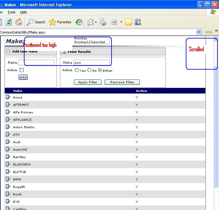

AutoCompleteExtender positioning -- if I scroll the page, the popup moves
Asked by: DanielWilson
I am trying to use the very cool AutoCompleteExtender from http://Asp.Net/AJAX in my application.
But positioning the list is driving my crazy.

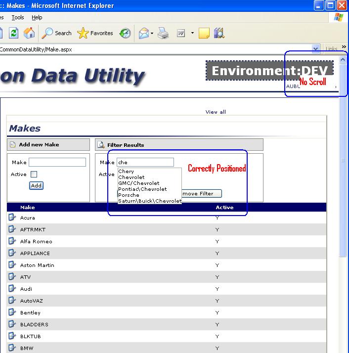

If I don't scroll my page down before making the list drop, it's fine.  But if I do scroll, the list goes up the page and does not display with my text box.

by: DanielWilsonPosted on 2008-07-10 at 05:06:06ID: 21972407
Ok, I've changed the code back to not use the panel so you can see the result.  See how it's fine when it's not scrolled but positioned wrong if I scroll down.
Repositioning is mentioned here: http://forums.asp.net/p/1252391/2329113.aspx though that's not exactly the example I followed ...
http://forums.asp.net/t/1182686.aspx is the one I did follow.
