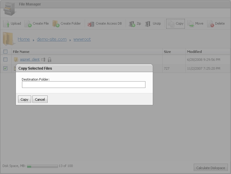

by: moghazaliPosted on 2009-05-11 at 14:44:44ID: 24359373
As I already mentioned in my post above that you may have to:
Create a section of the same page that may appear below the grid or in a modular popup such as ThickBox (http://jquery.com/demo/thickbox/) or ModalPopup (http://www.asp.net/AJAX/AjaxControlToolkit/Samples/ModalPopup/ModalPopup.aspx) where the paths available for copying the files be displayed in a listbox or a custom control which may also allow browsing of various paths on the server (see the attached screen shot DotNetPanel popup path browser). Make use of appropriate validators to force user to select a target path before clicking Copy Files button.
