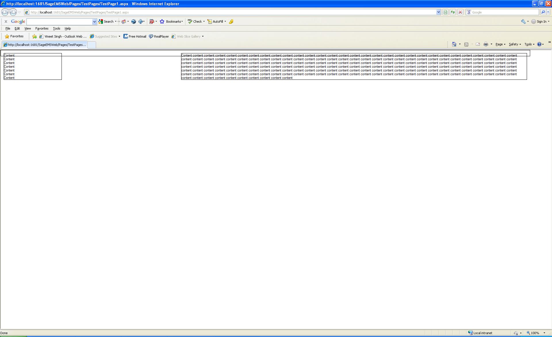

by: manivineetPosted on 2009-06-18 at 20:44:48ID: 24663728
@Quaor and @dachusa
you solution doesn't seem to work
here is a screen shot of what I produced
please have  look at the code an see if I 'am doing something wrong

by: QuaoarPosted on 2009-06-18 at 21:18:01ID: 24663829
Insert the following and play with the numbers a bit.  Put it at the top of the CSS.  You'll probably need to change some percentages to get things working properly.
The previous code worked great in browsers' quirks modes, but the doctype changes stuff.
html, body {
	height: 100%;
by: GreatGermPosted on 2009-06-22 at 08:41:31ID: 24683572
