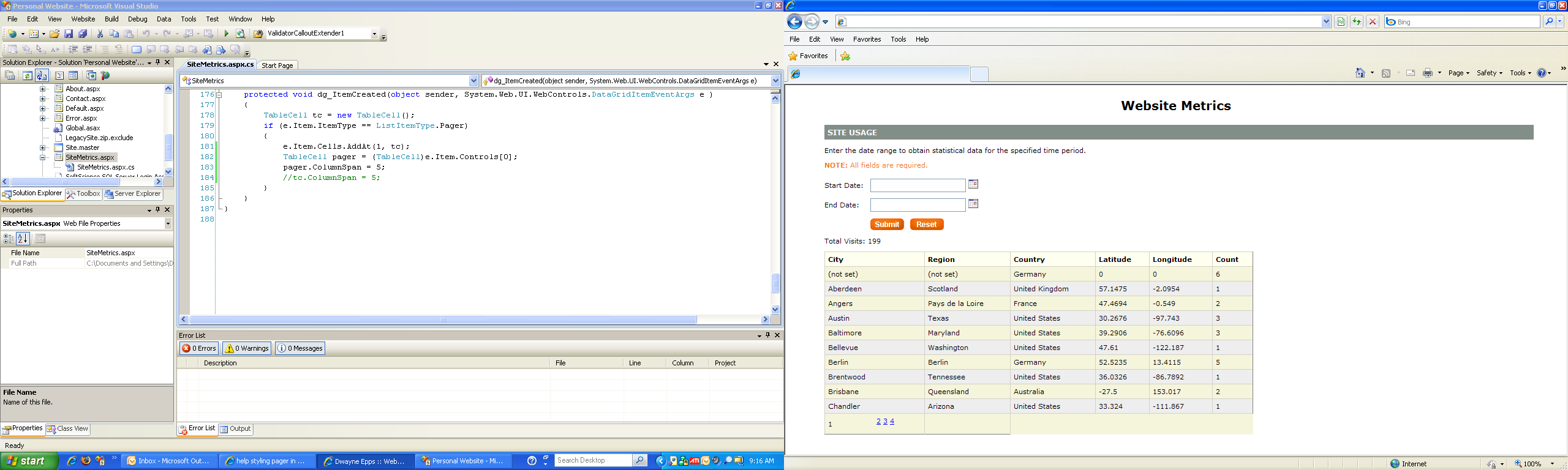

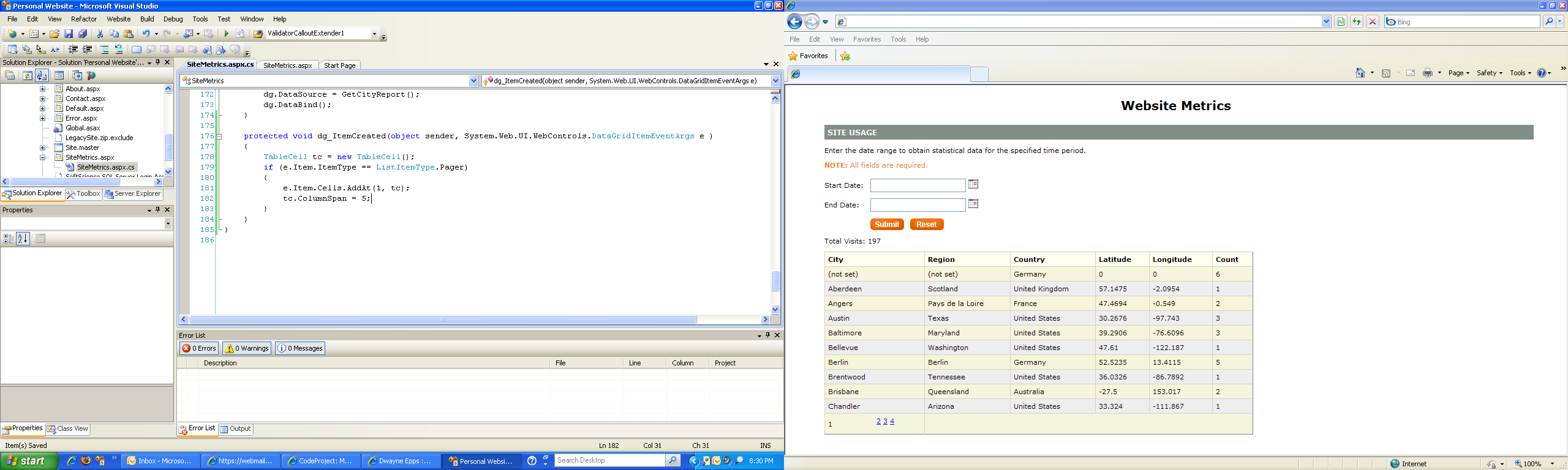

I am trying to modify the pagerstyles for a datagrid programmatically using the OnItemCreated event handler.
Specifically, I'm trying to set the columnspan so that the row for the page spans the entire width of the datagrid (see screenshot).
Also, I'm tryin to add Page 1 of n pages with brakets around each page...i.e.
Page 1 of 5     [2] [3] [4] [5]
Thanks for any help.

by: tovvenkiPosted on 2009-08-20 at 03:44:27ID: 25140886
can you try this
TableCell tc = new TableCell();
if (e.Item.ItemType == ListItemType.Pager)
            e.Item.Cells.AddAt(1, tc);
            TableCell pager = (TableCell) e.Item.Controls[0];
             pager.ColumnSpan = 5;
I hope that this helps you
Thanks and regards,
Venki
by: -Dman100-Posted on 2009-08-20 at 07:21:26ID: 25142846
Hi Venki,
I gave that a try, but it only rendered two columns and they weren't merged (see screenshot).
Here is the output from the html for the pager row.  It is still generating two columns instead of just one.
<tr>
<td><span>1</span>&nbsp;<a href="javascript:__doPostBack('dg$ctl14$ctl01','')">2</a>&nbsp;<a href="javascript:__doPostBack('dg$ctl14$ctl02','')">3</a>&nbsp;<a href="javascript:__doPostBack('dg$ctl14$ctl03','')">4</a></td><td></td>
</tr>
