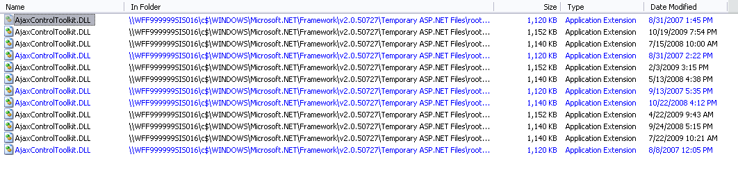

Here is a list of a bunch of AjaxControlToolkit dlls in a "...Temporary..." directory on the Server.  Could my app be getting crossover from these files?
