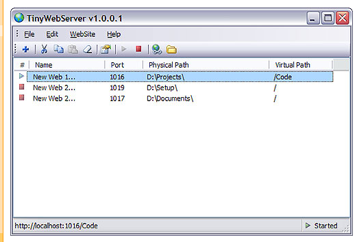

I think the built in "asp.net development server" is quite buggy. Since I have no possibility to use IIS, I want to use TinyWebServer:
http://www.codeproject.com/KB/aspnet/TinyWebServer.aspx (download etc)
Problem: I can't get my sites (under development) to run under TWS. How to do it?
(Ie do I have to "publish" first or something?)

by: davidsperlingPosted on 2009-10-27 at 02:36:22ID: 25670481
Seems like you can't access a website with TWS if you have built it as a solution (.sln).
This worked for me (at least once):
-close Visual Studio
-close TinyWebServer
-open VS and open your project with Open Website
-build website
-now run and configure TinyWebServer
-in TWS, right click on your site an launch
strange indeed ...
Also I had to set permissions for /image directory, or images won't be displayed.
Environment: Windows 2000  & VS2005
by: davidsperlingPosted on 2009-10-27 at 08:35:07ID: 25673577
Or maybe you just have to close the project in VS... Dunno.
