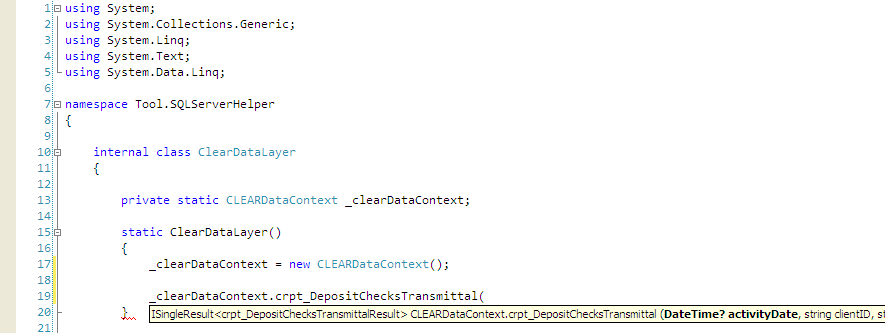

by: TheLearnedOnePosted on 2009-11-04 at 08:21:10ID: 25740901
When you drag and drop a stored procedure, the code generator generates the new method in the .designer file for the DBML.  You can call that method from the DataContext.
Here is an example:
