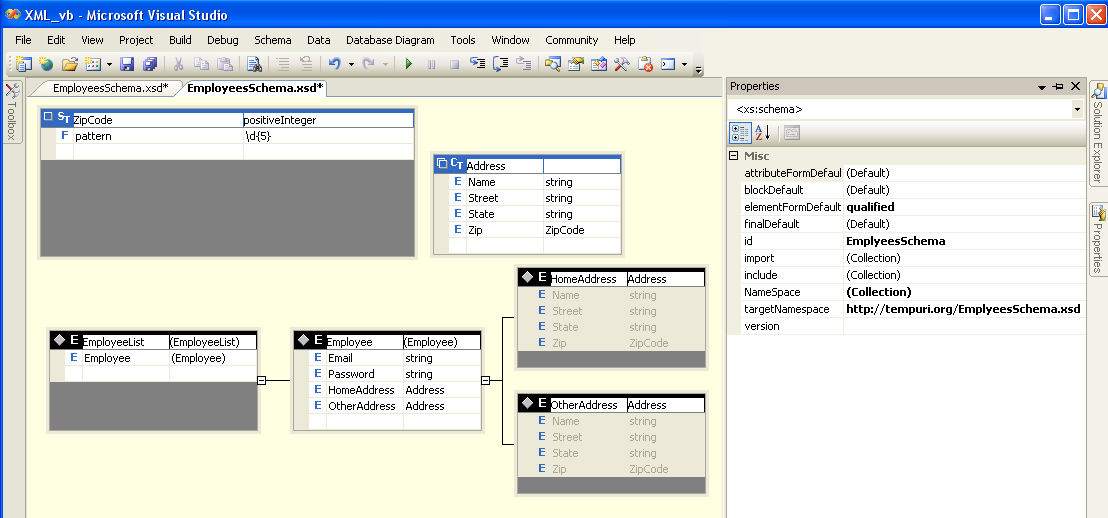

I started by creating the .xsd in Design view:
{xsd-01.png}
This automatically converts to the code view I provided in the 'code snippet' above.

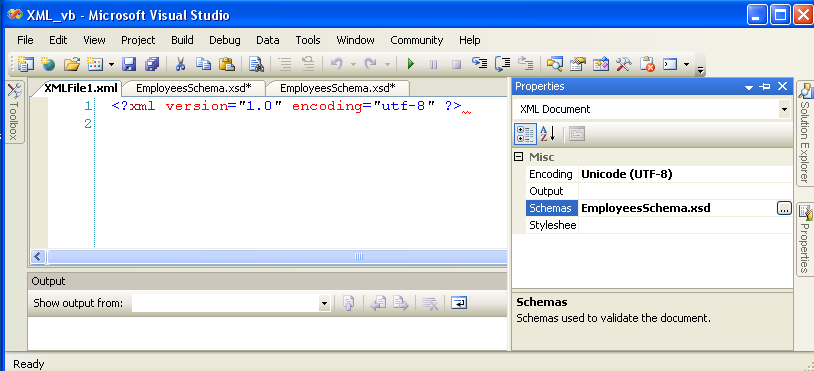

I then created a new xml file. This defaults to the single line file as shown in:
{xsd-02.png}

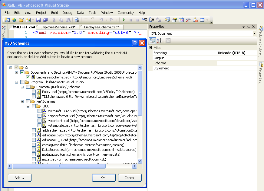

To associate the new xml file to the xsd, I went to 'Properties/Schemas' and clicked on the elipsis.  ...     .  This opens the XSD Schemas dialogue box.  I select the XSD I have just created and click OK.
Also: {xsd-02.png}
At this point, according to the LearnVisualStudio video, we would like the xml file to be amended by Visual Studio to reference the xsd file - but this does not happen.
File {xsd-03.png} shows the end result. The Schemas property is referencing the xsd file .. but the text of the xml file does not change ..
Note all along, the red 'squiggly' at the end of the single line of code in the xml file. Hover the cursor over this and get the message 'xml file must contain a root element'
