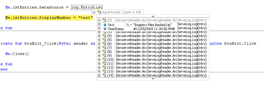

I'mexperiencing problems when I try to bind a List containing different objects, to a listbox control.

Then I try to bind the EntryList to the listbox by specifying a datasource and a display memeber:
        Me.lstEntries.DataSource = log.EntryList
        Me.lstEntries.DisplayMember = "text"
The result is that the listbox is beeing filled with object names or so (like ArcserveReader.ArcServeLogReader.ArcServeLog.LogEntry) in stead of the "text" value that resides in the list (see screenshot). I am using VB.Net Express 2008, and imho the list is filled with the correct data if I debug the code and look at this EntryList. However the needed data is some levels down. What do I need to do in orde to get the "text" or "time" values diplayed in the listbox?
Many thanks for helping me out.
Screenshot of List content in debug mode
