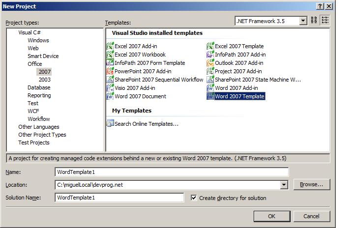

If you have VS2008 Professional you can use VSTO.
You can implement your document template in VB or C# not VBA:
en.wikipedia.org/wiki/Visual_Studio_Tools_for_Office
msdn.microsoft.com/en-us/vsto/default.aspx
Hope it helps,

by: mas_oz2003Posted on 2009-10-02 at 23:54:22ID: 25484181
OK, now that I answer your first question. here is some information to get you started
some links:
http://office.microsoft.com/en-us/templates/HA102373631033.aspx
http://code.msdn.microsoft.com/generateinvoicesvsto
by: Data-ManPosted on 2009-10-03 at 06:57:55ID: 31635870
The has been a radical change in creating Word templates since the release of Office 2007.  I think many people are looking for a quick fix to using 2003 Word Templates in Word 2007.  However, to do it the right way, I think the templates will need to be recreated especially if the template requires an interface via the Ribbon.
