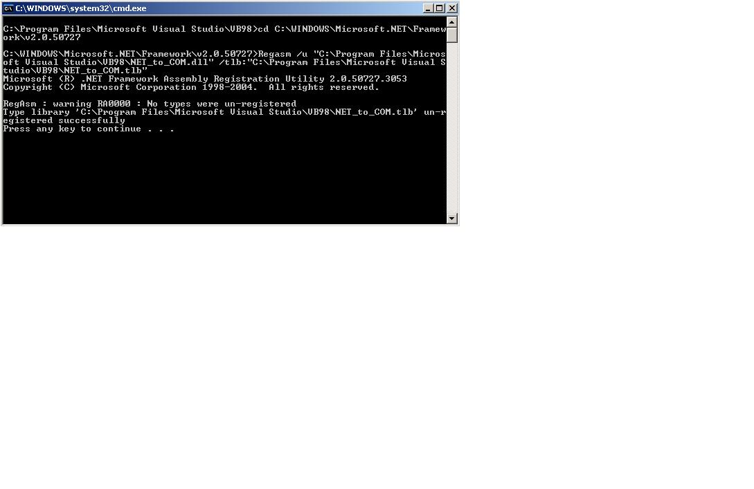

    I need to be able to use a .NET (VS 2005) class library in a legacy VB 6.0 project.  Here's what I have done so far:
- Marked the .NET class library as "Register for COM interop"
- Registered the DLL and created a .tlb using Regasm
- Referenced DLL in my VB 6.0 class
- Added the following code to my VB 6.0:
Line 1     Dim myNETClassInstance As MyNETNameSpace.CMyNetClass
Line 2     Set myNETClassInstance = New MyNETNameSpace.CMyNetClass
I get the following error on line 1 when I try to compile the VB 6 code: "User-defined type not defined"
VB 6 seems to recognize the .NET namespace because it capitalizes letters for me in the namespace name, but I don't think it's finding the CMyNetClass class within the NET namespace.
