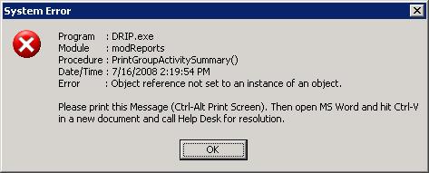

by: BlakeMcKennaPosted on 2008-07-17 at 07:47:12ID: 22025995
It's embedded in my application.
by: TheLearnedOnePosted on 2008-07-17 at 07:49:57ID: 22026034
I am confused why you are getting that error on your Terminal Server.  What line is it having a problem with?
by: BlakeMcKennaPosted on 2008-07-17 at 07:50:32ID: 22026042
Well, it's probably an external file. In my VB.Net project, I have several Crystal Reports that have naming conventions like rptGroupSummary.rpt. The following code is a DLL only because it is called by an online program as well as a batch program. I actually create each report from within the Crystal Reports IDE.

by: BlakeMcKennaPosted on 2008-07-17 at 08:00:50ID: 22026164
I don't think you can run an application in debug mode on a Terminal Server. If you can I've never done it.
As far as having a problem with a line of code....the application isn't giving me any errors except after the prompting of the parameters. I enter the same 2 parameter values 3 different times...once for each subreport. After I've done that is when I get the error message (see screen shot). Anyway, the code I provided is how I create all my reports using Crystal Reports.

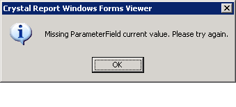

by: BlakeMcKennaPosted on 2008-07-17 at 08:01:49ID: 22026173
Here is the Error I get after parameter value entry.

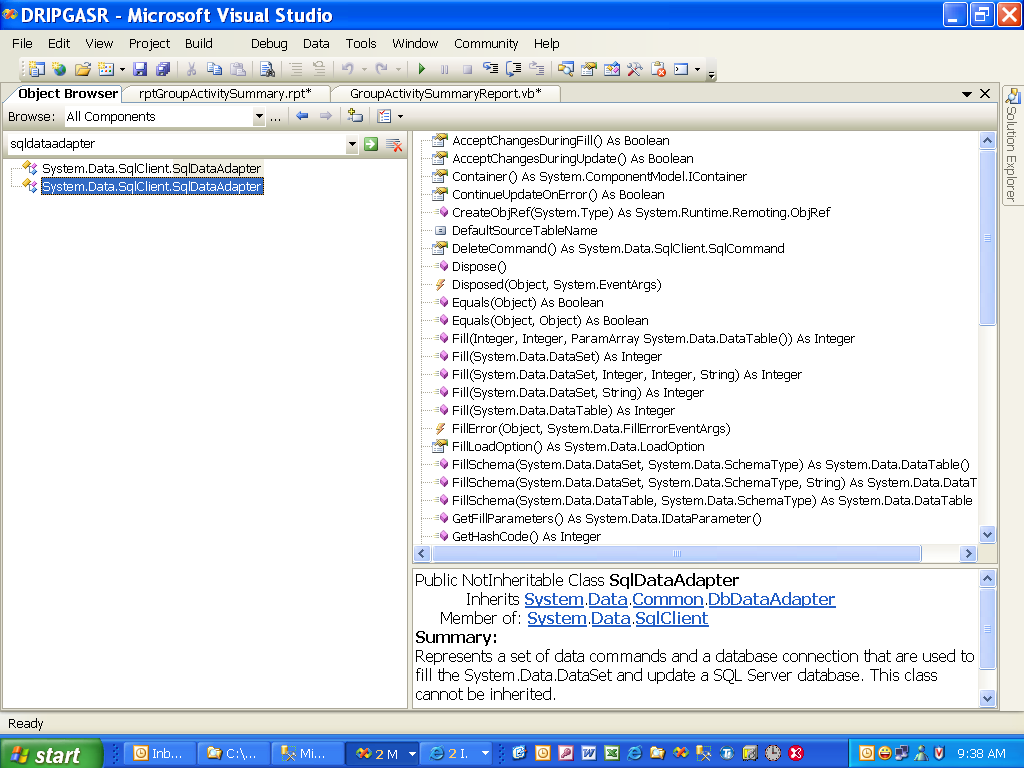

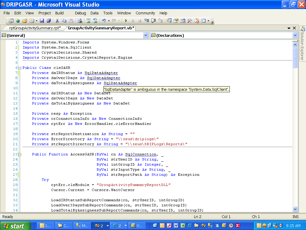

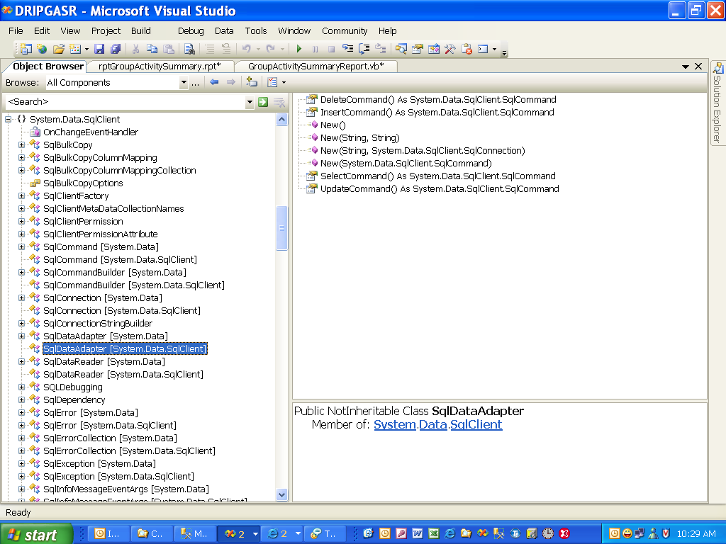

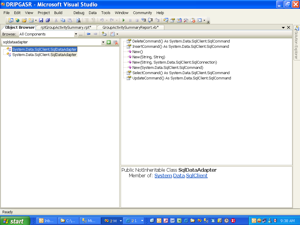

by: TheLearnedOnePosted on 2008-07-17 at 09:24:35ID: 22027138
Open the Object Browser, and search for SqlDataAdapter, and see if you find more than one entry.
by: BlakeMcKennaPosted on 2008-07-17 at 09:41:18ID: 22027282
Yes, I saw 2 of them. Here is what they look like. I don't know which one to remove.
by: TheLearnedOnePosted on 2008-07-17 at 10:18:29ID: 22027687
Look at all the references to System.Data in all the projects.
