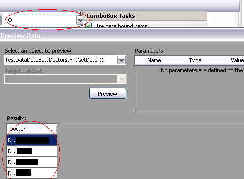

I have a combobox that I am trying to populate with a list of people who are saved in a column in my database table. I tried fiddling with the built in datasource options you get when you first place the box and I can preview the data with the preview option but it just DOESN'T want to put the results list in my box and i'm starting to pull my hair out to say the least.
I've gone through the settings and changed every option and can still see the preview of my names. All I can say is that the Target Dataset drop down menu in the Preview Screen is greyed out and the Parameters section on the right says No parameters are defined on the selected object.
How come i can preview the darn thing but it can't populate the combobox when i run my program? What am I missing?

In short, the built in data bound options don't seem to work. I can preview the table and it works, but when I run the program it doesn't list the names.
I've tried coding using datareader but it doesn't function the way i need it to.
I need the combobox to fill with a list of names from my database table. I also need ideas on the best option to be able to select multiple names if I want results for more than one doctor.
