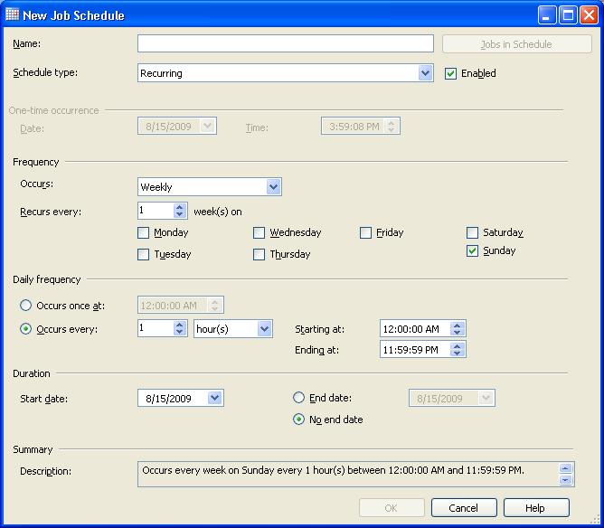

Dear Experts,
I have made an interface to build a schedule summary like sql server job schedule window when you create a new one. and i save all user settings in a database in sql server, so now i am going to make a new windows service or a program using vb.net to read all records from database and run those jobs, so is there a way to take the befinit from windows schedule to run those jobs or should i use a timer to do this, if will do it using my code, please can you tell me what is the best way to do it?

i am using a form asp.net that set the inputs as shown in the picture attached.
i need to transalte this picture to running as a timer

Okay, i know that i need to write whole code, but as you know i am saving those schuduling tasks in a table as a rows, means each row as a schedule task that contains a field (three types : txt path, or xml path or sql select statment) to be exucuted on each triggering that match the time. not like exe path or somthing like that. only executing somthing like sql statement. is it possible using those library to make it a custom.

How come puting for example the sql statment in place of Application Name of the Task Class to be executed and perform a connection to database or executing reading from a file if the row type of field (txt) means i must execute read a txt file from a path that exists in some fields of the same record, and if there is a new task job add in my database i must reflect the concurnet tasks avaiable here while it's running. I think it's hard to do all this customization that meas i must do it from the scratch, isn' it?
