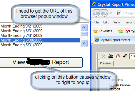

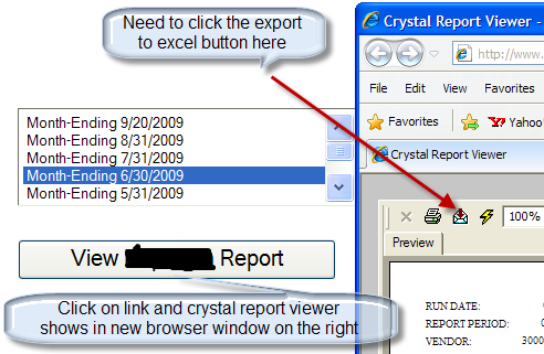

Hello,
I have create an automation script in VB .Net to go to login to a website and generate a report.
The report displays in crystal report view.   I need to programatically click on the export report icon and then at the next window type in a file name and click save
I attached a screenshot of what I'm trying to do.   Any insights, guidance, or sample code to get my started would be greatly appreciated.     Thanks!
  • CRV.docx
    • 74 KB
    shows the steps that need to be automated

by: Idle_MindPosted on 2009-09-03 at 10:44:21ID: 25253024
Can you "dumb it down" and simply click at a pre-defined offset based on the location of the webbrowser control location?
(not the best solution...and I really have no idea if your problem is possible using more reliable methods)
This would require that the form be visible and in the foreground, but then you could use the mouse_event() API:

When I run the code, IE browser automatically popups and shows the report in that window.
The webbrowser control isn't visible on my screen when I run the code.    Do you know how set this up so that so it appears in the control?
I went to the toolbox and dragged the webbrowser control thinking that might to the trick, but the behavior is still the same.
Here's some of the code:

by: lchaPosted on 2009-09-04 at 00:21:34ID: 25257375
I don't know how to do that off hand but will look further into this more tomm.  Have to get some rest now and be up early in the morning! :-)
Thx

I added the recommended new class to my project based on the example provided, extendedwebbrowser.vb
There is a new event in the extendedwebbrowser class called NewWindowWithTaget which has WebBrowserExtendedNavigatingEventArgs as args ...  it is mentioned that I can get the target url I need from it (see relevant code snippet)
How can I reference the needed URL?   I thought  to add a sub that handles webbrowser1.newwindowwithtaget .... and try to get the value of the url as in the code snippet but i'm getting an error that 'type parameters cannot be used as qualifiers'.    I'm new to vb .net and probably not understanding some fundamental concepts here.

Hi theLearnedone,
Appreciate your help on this one and understand it's a lot to read through so I'll try my best to simplify and resummarize everything.   The webbot I wrote clicks on a button on a web page to generate a report which triggers a new browser window pops up w/ a report displayed by crystal reports ActiveX viewer.   Since an ActiveX viewer is being used instead of HTML I can't programmatically invoke the click of the button as I can in HTML.   Please see attached screenshot.
The 1st approach recommended which I held off on so far is to use extend mappoint the MapPoint ActiveX control   http://www.mp2kmag.com/articles.asp?ArticleID=88
The alternate approach I'm trying now to click on the "export to excel" button by, " clicking at a pre-defined offset based on the location of the webbrowser control location.  This would require that the form be visible and in the foreground, but then you could use the mouse_event() API ...you can trap the NewWindow2 (or NewWindow3...not sure) and then grab the URL and make it open in the current WebBrowser"
I'm trying to use the link the expert provided as a possible solution to what I'm trying to do.
http://www.experts-exchange.com/Programming/Languages/.NET/Visual_Basic.NET/Q_22992480.html
It recommends the following:
"Make a class named ExtendedWebBrowser.vb and paste the code below in it.( see code snippet)
then use ExtendedWebBrowser instead of WebBrowser and you will have a new event in it, called
NewWindowWithTaget which has WebBrowserExtendedNavigatingEventArgs as args, you can get the target url from it "
*********************************************************************************************************************************II'm trying to figure out  how to get the URL from the window popup as described in the recommended solution
Looking at the code snippet below, how would I get URL?    URL is a property of "WebBrowserExtendedNavigatingEventArgs" class which is an argument of Event, "NewWindowWithTaget".
This class I'm using (ExtendedWebBrowser.vb) which inherits the webbrowser control is supposed to allow me to get the URL on the window popup (the one showing the report with crystal reports viewer).   From there, I can use the url to put the content of the window popup (the crystal report) in the current WebBrowser.     Finally, I would use the approach of clicking on a predefined offset to click on the "export to excel" button using the mouse_event api.
If you can think of a better or easier way to do this, please let me know.    Please let me know if you need more clarification.    Thanks again for the help!

by: CodeCruiserPosted on 2009-09-21 at 08:03:47ID: 25383626
The trouble is, as the viewer is an ActiveX control, it is not drawn using HTML so there is no button that you can press programmatically. Also, there is no shortcut key i guess. And as you can not be sure of the focus, you can not use the sendkeys option. So i think you are not going anywhere with this issue. I heard crystal report viewer also has a DHTML version as well as the ActiveX. But i think this is the choice of the developer rather than user.
by: lchaPosted on 2009-09-21 at 08:09:26ID: 25383682
But isn't it still possible as described to click at a pre-defined offset based on the location of the webbrowser control location.    Would that allow me to click on the button?   Idlemind was saying, "it would only work if you could be reasonably sure that the button would be at a specific location within the webbrowser control"
by: CodeCruiserPosted on 2009-09-21 at 08:15:25ID: 25383750
Yes. What idlemind said is correct. Are you sure that the location of the button is always constant?
by: lchaPosted on 2009-09-21 at 08:29:57ID: 25383923
"And as you can not be sure of the focus, you can not use the sendkeys option. "
- Could you further explain or elaborate on what you meant here?

by: CodeCruiserPosted on 2009-09-21 at 08:31:26ID: 25383943
I dont think you can direct the mouse input to a button when the window has the focus.
by: lchaPosted on 2009-09-21 at 08:34:13ID: 25383981
"Are you sure that the location of the button is always constant"
- If I properly understood what you meant by "constant", I believe so yes.    The location of the button (in screenshot) is always the same.

I have never used the approach mount_event api but what would be the issue to click the button when the window has the focus?
In the approach I'm trying to figure out now, I need to figure out how to get the url of the window browser popup and navigate to it in the webbrowser.    From there, programatically click on a predefined offset.   Sorry if I am repeating myself unnecessarily.

by: TheLearnedOnePosted on 2009-09-21 at 11:34:02ID: 25385982
Mouse down and mouse up should be separate actions, so you would need to do something like this:
SetCursorPos(100, 100)
mouse_event(MOUSEEVENTF_LEFTDOWN, 0, 0, 0, 0)
mouse_event(MOUSEEVENTF_LEFTUP, 0, 0, 0, 0)
by: CodeCruiserPosted on 2009-09-22 at 01:06:36ID: 25390484

by: lchaPosted on 2009-09-22 at 08:36:26ID: 25394038
For point of reference and communication, I see the current approach as separated into two parts as noted below.   If either of you are thinking of or know of a better or more practical approach that is great too.
*PART I *
- getting the URL of the popup browser window (w/ the crystal report displayed) and using that URL to load that content into the webbrowser (extended webbrowser in this case) instead.
Did the attached code that I used for ExtendedWEbbrowser.vb  - comment (25383543) look like a viable solution?   I would be using "ExtendedWebBrowser" instead of WebBrowser and there is an event in it, called
NewWindowWithTaget which has WebBrowserExtendedNavigatingEventArgs as args, where I can get the target url (the url of the window popup w/ the crystal report).   I'd use that url and navigate to it with the webbrowser or extendedwebbrowser.   Understanding how to et the url was where I got stuck
*Part 2*
 -  clicking at a pre-defined offset of the webbrowser based on the location of the webbrowser control location to programatically click the "export to excel" button.
"I dont think you can direct the mouse input to a button when the window has the focus"
- Codecruiser, I didn't understand this.  So were you thinking that the approach wouldn't work then?
Thanks again for your help.
by: CodeCruiserPosted on 2009-09-22 at 08:47:33ID: 25394178
No i was on about SENDKEYS approach. When using SendKeys, the input is directed to the focused window unless you are sending some shortcut key.
by: lchaPosted on 2009-09-22 at 09:42:46ID: 25394750
argh, it's hard to communicate in writing sometimes :-)    Did you mean that sendkeys may be the right approach here because the input is directed to the focused window?     If so I don't know what keys I would send to communicate with the export button.
Also, what about "Part I" that I described .. is this approach reasonable and was it clear what I'm trying to accomplish with that code and what my question is about how to get the URL?

by: TheLearnedOnePosted on 2009-09-22 at 10:25:31ID: 25395223
I don't believe that SendKeys will get you what you need, unless there are shortcut keys that would press the button.  What happened with the mouse down/mouse up calls?
by: lchaPosted on 2009-09-22 at 10:43:32ID: 25395454
I haven't attempted anything with the mouse down/mouse up calls yet since that would be the next step.   I needed to first get the report in the webbrowser.
Is the question that I asked previously unclear still?   Please let me know if it is.
I'm have been trying to get help for "Part I" of the problem.    I don't have a sense of whether either of you are clear on my question.   Did either of you have time to see the code?   I'm attaching it below again.
*PART I *

- ID 25395454
by: lchaPosted on 2009-09-22 at 11:02:35ID: 25395656
Looking at the code snippet I provided, how would I get URL?    URL is a property of "WebBrowserExtendedNavigatingEventArgs" class which is an argument of Event, "NewWindowWithTaget".
says:
Make a class named ExtendedWebBrowser.vb and paste the code below in it..
See screenshot below and code.

by: CodeCruiserPosted on 2009-09-23 at 00:22:35ID: 25400656
Right. I meant to say that SendKeys would NOT be a suitable solution here.
To get the URL, in the new window popup handler, use the e.URL property to get the url.
by: lchaPosted on 2009-10-08 at 01:03:35ID: 25523014
Sorry I left this open for so long but I'm still working on this issue.
Part I - getting the URL of the popup window using extendedwebbrowser class.
- I just got this part to work so that I'm able to obtain the URL of the popup.
Now I need to trap the NewWindow2 (or NewWindow3...not sure), grab the URL and make it open in the current WebBrowser.
Codecruiser, you mentioned, "I dont think you can direct the mouse input to a button when the window has the focus".
Once, I load the popup window into the webbrowser control, my plan was to use Idlemind's suggestion to click at a pre-defined offset based on the location of the webbrowser control location.    In your statement above statement, were you saying this might not be possible?

by: lchaPosted on 2009-10-30 at 09:53:09ID: 25704798
Summarizing the issue again so you don't have to read everything from scratch.
I have used the webbrowser control to automate the process to login to a website, click on a link (page 2), make a selection in a listbox(page 3), and click a button to submit a form with values to generate a report.
Once the form on the web page is submitted, it generates a browser popup window and displays the reports in crystal reports viewer.
I need to figure out how to click on the export to excel button.
Originally I was taking the approach to get the URL of the popup window that displays the crystal report and load it into the webbrowser so I could click on a predefined offset (using mouse_event api)
This doesn't work though because it requires those parameters that are passed in the form.
If any clarification is needed, please let me know.   Thanks!

by: lchaPosted on 2009-10-30 at 12:53:24ID: 25706263
Hello,
I really need some more help or direction on this new approach of using httpwebrequest.
So should I use httpwebrequest with webbrowser control so that I can load the results of the form request into the webbrowser control?   then, click on a predefined offset to click the export to excel button?
I don't think I can use httpwebrequest to submit the form needed to generate that crystal report unless I login to the website again.
I can try to recreate this example using vb .net
http://www.experts-exchange.com/Programming/Languages/.NET/Visual_Basic.NET/Q_22932294.html
So do I need to figure out how to login using httpwebrequest and then find the relevant values on the form to submit from my program?
Still, I don't know how I'm going to click on that export to excel button in the active X viewer.
Thanks!

by: lchaPosted on 2009-11-02 at 14:14:37ID: 25724364
is there a way to get the results of the popup window (crystal report) to display in the webbrowser  control?
Is it necessary to have the popup display in the webbrowser control?    Couldn't I just click on a predefined offset of the popup window to click on the export report button in the active x viewer?
As I mentioned before getting the url - http://www.xxx.com/xxx/xxx/xxx/xxxxReports/xxxs.rpt
and navigating to it form the webbrowser doesn't work as the parameters to generate the report are missing.
by: TheLearnedOnePosted on 2009-11-03 at 10:57:22ID: 25732196
Have you thought about defining a custom tool bar, and use the underlying export functionality of Crystal Reports, instead of trying to click a button?
by: lchaPosted on 2009-11-03 at 11:03:57ID: 25732281
hello, thanks.   I didn't understand what you meant defining a custom tool bar.   Could you elaborate on that?  Also, in what way or how is it possible to use the underlying functionality of Crystal Reports to accomplish the same as clicking on that button?
by: TheLearnedOnePosted on 2009-11-03 at 11:36:30ID: 25732621
I had a crude example, where you could turn off the report viewer toolbar, and use another mechanism (like buttons).  I was thinking about the Windows Forms report viewer, and not the ASP.NET version.  I don't think that the ASP.NET version supports exporting from the code-behind.

by: TheLearnedOnePosted on 2009-11-03 at 11:43:53ID: 25732702
It appears that the export functionality comes from the report class, instead of the report viewer.
How to Export Crystal Report in ASP.NET

- Once I find the match, find the child window where the class name = ATL:07868280 (I used spy++ to find the lower level window and get the class name of where the export button is located.)
When I run the code it is able to find the window with that export button on it so it seems Ive narrowed the area that needs to be clicked on.
Now, I am trying to figure out how to click on the appropriate coordinates.

the screenshot below is of the child window I am trying to click on now.
by: lchaPosted on 2009-11-03 at 14:58:22ID: 25734830
I am passing the handle of the childwindow (the toolbar area) to GetWindowRect.
So for example, using ClickAt(DialogRect.Left + 35, DialogRect.Top - 5, True, False)
DialogRect.Left + 15 thru + 35 appear to be clicking on the refresh button.   I can see the the window refreshing... there is a bar on the right side of that window that shows the refresh taking place.  not sure if because I'm clicking on the refresh button or not.
Since the export button is to the left of the refresh button I have tried decreasing the #  + 0 to + 15 but it's not clicking on the export button.
Note: for DialogRect.Top I used a negative number because .Top gets the y-axis position of the top of the rectangle.   If I use a positive # I'm not able to make any contact with the buttons.
I still a bit unclear on how to get the "offset".   When I enter + 50, how far to the right is this of the left side of the rectangle?    Does +50 mean 50 pixels and how much is that .. is it a millimeter, inch?
Does +50 move the position or coordinates from 771 to 821 on the x axis?
.Top - Gets the y-axis position of the top of the rectangle.  - Since the button is below the top, should this # be negative?
.Left - Gets the x-axis value of the left side of the rectangle.
   GetWindowRect(aw.Handle, DialogRect)
                        Debug.Print("left " & DialogRect.Left.ToString)
                        Debug.Print("top " & DialogRect.Top.ToString)
                        Debug.Print("top max val: " & DialogRect.Top.MaxValue.ToString())
                        Debug.Print("top min val: " & DialogRect.Top.MinValue.ToString())
                        Debug.Print("Left min val: " & DialogRect.Left.MinValue.ToString)
                        Debug.Print("Left max val: " & DialogRect.Left.MaxValue.ToString)
                        ClickAt(DialogRect.Left + 200, DialogRect.Top + 100, True, False)
I don't know if I'm interpreting this correctly or if it matters really but seems the range for that small rectangular tool bar is between -2147483648 and 2147483647?
Debug.print results:
left 771
top 174
top max val: 2147483647
top min val: -2147483648
Left min val: -2147483648
Left max val: 2147483647
by: Idle_MindPosted on 2009-11-03 at 15:23:21ID: 25735013
"DialogRect.Top.MaxValue" has no bearing on your actual rectangle.
What you're doing there is getting the min/max for ANY Int32 variable.
by: lchaPosted on 2009-11-03 at 15:29:04ID: 25735046
ok, I misunderstood.
I took a screenshot of the child window (or toolbar area with the export button) as you suggested and then cropped the image so just that toolbar bounding box is visible.
I took the screenshot in my snag it tool - when I highlighted over the export button I can see the coordinates at the bottom of the screen
63,13
169X19X24 bit
I tried changing the code as follows:
        ClickAt(DialogRect.Left + 60, DialogRect.Top + 13, True, False)
but the window doesnt' respond
