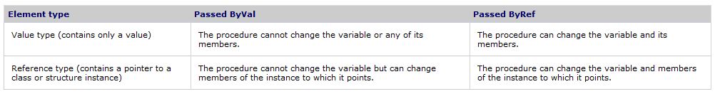

by: Idle_MindPosted on 2009-10-27 at 08:11:06ID: 25673271
I think the biggest difference is that a Class is a Reference Type while a Structure is a Value Type.
This comes into play when you start passing them around:
http://msdn.microsoft.com/en-us/library/eek064h4(VS.80).aspx
When you pass a Class ByVal you can change the items in the parameter.
When you pass a Structure ByVal a COPY is made and changes to the items are only local.
When you pass a Class ByRef you can change the INSTANCE the original variable points to.
When you pass a Structure ByVal you can change the items in the original variable.
Summed up in the Table from the link:
    • 37 KB
    Differences in passing ByVal & ByRef for Reference/Value Types
