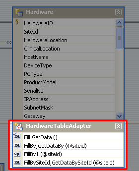

The main question is related to Table Adapters:
There is a dataset with several table adapters, each with several queries attached.
The Table Adapter in which I am interested is [Hardware].
There are 4 different queries attached to it.
1 is just a SELECT *
1 is a SELECT * WHERE... query.

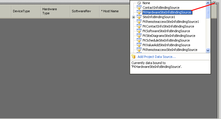

When I implement my Gridview and choose my Data Source, the SELECT * query is the default.
However, I cannot select the other query from that binding source.
I have attached an image of the Table Adapter and an image of the Gridview with the dropdown of the binding sources with my desired source selected; however, it defaults to the SELECT * query.
How can I get it to select the other query from that data source?

by: lshanePosted on 2009-11-04 at 13:41:57ID: 25744261
Ah, it sounds like you're asking the questions I was trying to ask, but didn't know how.  LOL
The Table Adapter for this [Hardware] data source consists of 4 different queries (And I could add more if I wanted).
One is a SELECT *, and subsequently displays everything from the table (This query seems to be what the gridview defaults to when bound to this data source).
There is another query in there (See image), that is a SELECT... WHERE statement.  I want to use that one for a different gridview.
Maybe I don't understand the full scope and purpose of a Table Adapter.  It would seem to me if I can add multiple queries in a Table Adapter, that I should be able to "call" each one as needed when bound to that respective Data Source.
I hope that clears it up a little.  :)
