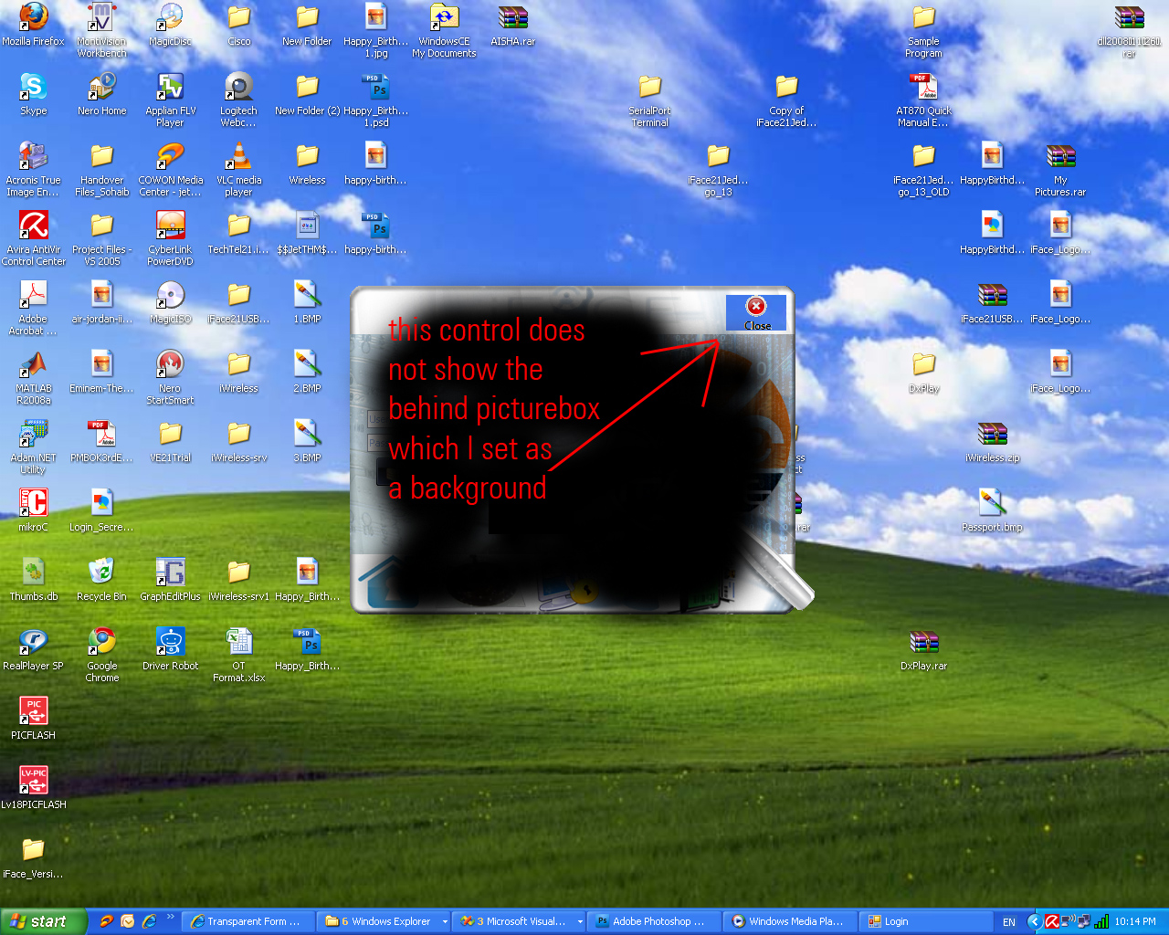

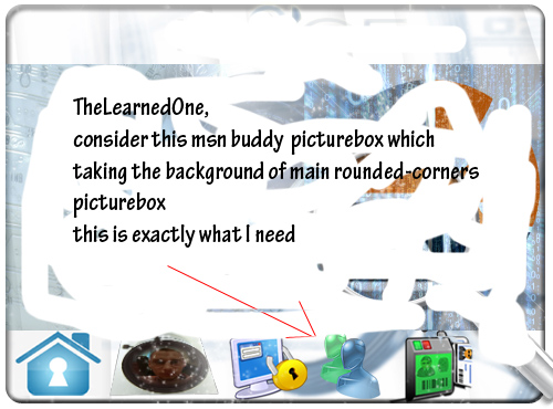

I have set the transparent key property of a form to same color of backrgound of that form and I have set the border style of that form to none
I have a picture box control which I want to use it as a backgroud so I set some background image to that picture box
now I have another picture box control (which has icon or png logo) which should be transparent to the main picture box (which meant to be as background for all other controls), but the problem that is that when I make this logo picture box as tranparent, its showing nothing as a background !!
I tried to solve this to set the form's background image property to this background image, it works but the problem the back ground image here is repeated in both X and Y axis
2009-10-26 at 23:32:04ID24846248

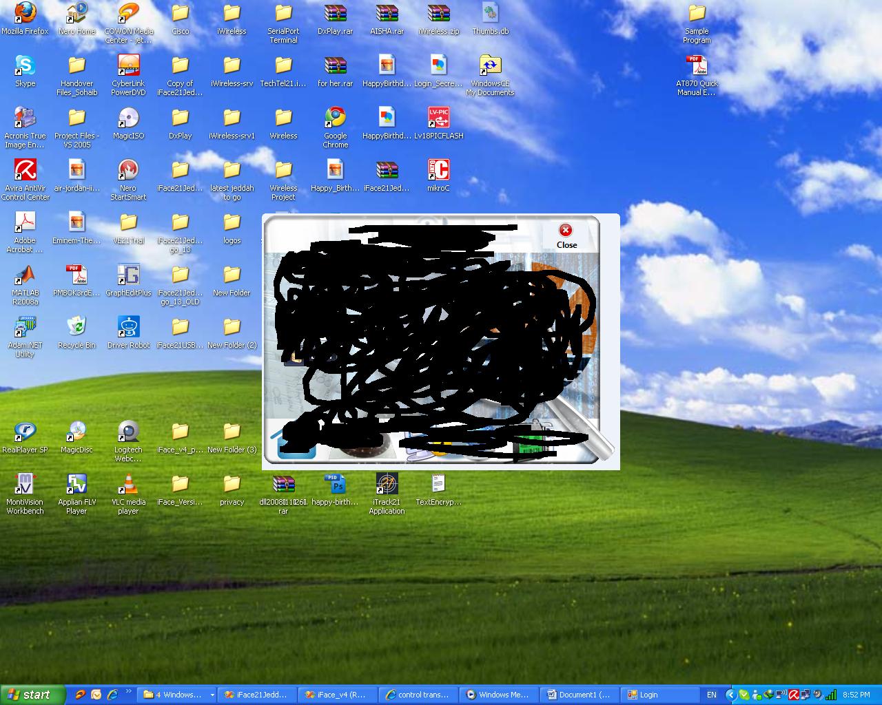

by: Ameerh24Posted on 2009-10-27 at 08:09:35ID: 25673253
hi, still the same problem after I set it to auto,
isnt there anyway to stop repeating form (or panel) background ??

by: Ameerh24Posted on 2009-10-30 at 10:48:41ID: 25705287
when I set alpha to 0 its not working !!!!
this.BackColor = System.Drawing.Color.FromArgb(((int)(((byte)(0)))), ((int)(((byte)(243)))), ((int)(((byte)(250)))));
this.TransparencyKey = System.Drawing.Color.FromArgb(((int)(((byte)(0)))), ((int)(((byte)(243)))), ((int)(((byte)(250)))));
its showing the background  of the png picture !!!

here is the snapshot of what happens when I set alpha channel to 0:
by: bhmahlerPosted on 2009-10-30 at 11:29:51ID: 25705636
You haven't actually set the Alpha channel there in your code, but it doesn't matter, it won't work anyways.  Do you have a transparent background color on the png?

by: Ameerh24Posted on 2009-11-02 at 15:17:54ID: 25724800
I want to use a tranparent form so that I can put rounded-corner picture ( which would be png type ) which also gonna be used as a background to another controls .. now all other controls should be transparent to this background png
for example ..
suppose there is a circle (or not sqaure shape) image ( e.g. msn buddy ), so the remaining part of the picture should be transparent and to the main background rounded-corner png
by: TheLearnedOnePosted on 2009-11-02 at 19:40:47ID: 25725887
I believe that what you are describing is an irregularly shaped form, as in the concept of GraphicsPath and a region:
Irregularly Shaped Forms in VB.NET (Demo)
http://www.freevbcode.com/ShowCode.asp?ID=3723
