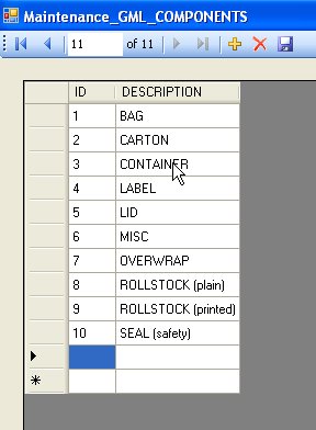

How can I setup the attached so users can
"Add New Items" but not edit/delete existing ?
Steps I did:
 1. click on "gML_COMPONENTSDataGridView"
 2. Properties
      ** AllowUserToDeleteRows = False
 3. go into "EditModeChanged" EVENT
 4. add something to below ?
        private void gML_COMPONENTSDataGridView_EditModeChanged(object sender, EventArgs e)
            if (new, then allow save)

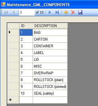

by: finance_teacherPosted on 2009-11-05 at 12:44:58ID: 25753807
I already had
  AllowUserToAddRows =true;
  AllowUserToDeleteRows = false;
Adding
  ReadOnly=true;
allows user to click "+" so it looks like they can add a row, however it still remains ReadOnly so users cannot add a row (attached)
I am using dotNet 2.0
How can I get this to work ?

by: finance_teacherPosted on 2009-11-05 at 13:16:18ID: 25754136
Below gives errors
What is the correct C# syntax ?
        private void gML_COMPONENTSDataGridView_RowEnter(object sender, DataGridViewCellEventArgs e)
            var vGridRow = gML_COMPONENTSDataGridView.Rows(e.RowIndex);
            if (vGridRow.IsNewRow == false)
                  vGridRow.ReadOnly = true;;

by: finance_teacherPosted on 2009-11-05 at 13:58:00ID: 25754508
Changed DataGridView
 ** AllowUserToAddRows = true;
 ** AllowUserToDeleteRows = false;
 ** ReadOnly = true;
Added below
** fails, makes everything readonly,
   even when doing "+" sign
            DataGridViewRow r = this.gML_COMPONENTSDataGridView.Rows[e.RowIndex];
            if (r.IsNewRow)
                  r.ReadOnly = false;
How can I fix ?
