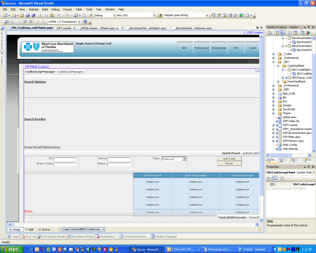

by: ina_donPosted on 2008-08-25 at 12:33:36ID: 22308386
I read somewhere about how the rendering engine or something to that effect was improved in 2008. This meant that those pages that would render in 2005 albeit poor code, would now show in 2008 and Internet Explorer 8 or Firefox 2.5 and above would also show poor code. Try and adjust you pages or perhaps use absolute sizes and positioning and see if that improves the situation.
by: JeffreymarcumPosted on 2008-08-25 at 13:52:30ID: 22309165
So specifying control sizes, etc in CSS would cause a problem for the VS2008 renderer? Positioning is handled with <div> tags in the HTML

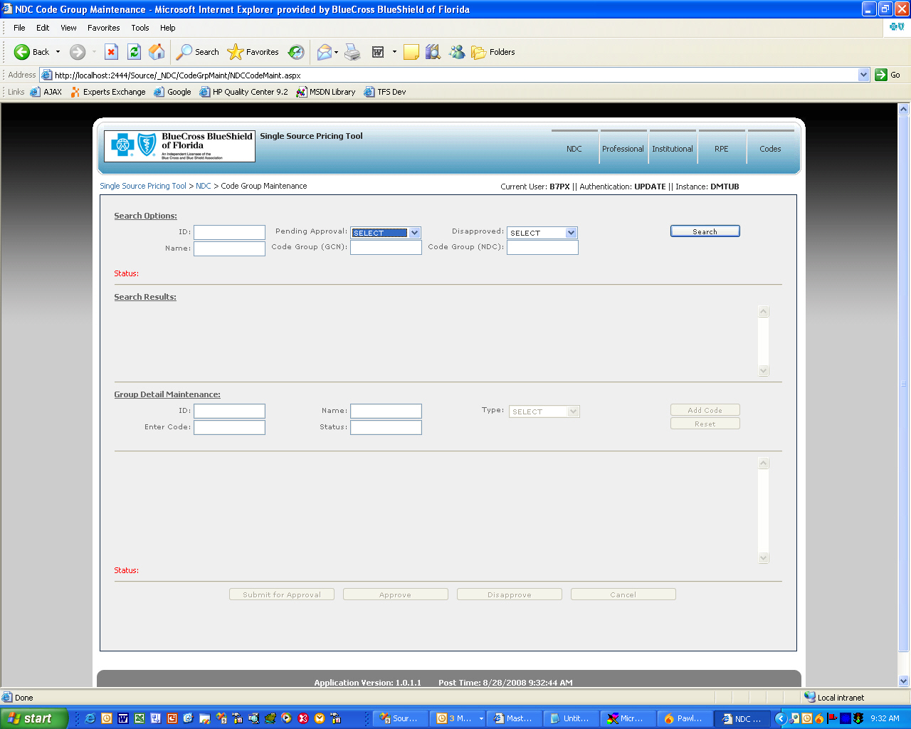

by: JeffreymarcumPosted on 2008-08-28 at 06:34:53ID: 22334559
I've included the master page code snippet and a screenshots of how the design view in VS2008 is skewed but when the page is hosted, it renders fine.
