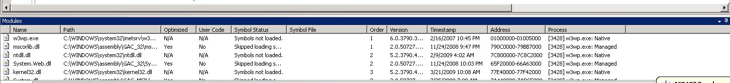

I am trying to hit the breakpoints in my code but when i attach to the w3wp.exe process  the symbols are not loaded.
Please see image.
I have the project pointing to IIS on my machine where the websites are configured.

If the dll's and the code are different versions, you'll have trouble attaching the debugger. But here's a nice article describing the details of the process:
http://www.odetocode.com/Articles/425.aspx

Hi nmarun,
My dlls and pdb files are in the same folder wiht the same timestamp. I have deleted and rebuilt the web apps and they were recreated.

Did the article help?
by: nirisanPosted on 2009-09-12 at 04:22:46ID: 25316031
yes,, thanks
