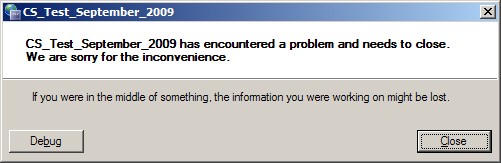

** My console apps and WinForms apps created in C# (or VB) will NOT start from the command-line.**
... even "Hello, World!" fails.
I receive a dialog box (from DW20.EXE (Dr. Watson?)) saying:
"___ has encountered a problem and needs to close."
"We are sorry for the inconvenience."
** They will, however, run in the IDE in either Debug or Release mode.**
Apps created with C++ and even STARTED with C++ containing libraries and projects created in other languages work just fine.
** Also, if I install the programs on another machine, they work fine.**
I'm assuming something has "geeked" my GAC or something is wrong in the path.
I've mirrored the path of a functioning machine, I've done a "repair" on the VS installation
and I've done a bunch of updates from Microsoft (before, during and after the problem).
** I noticed the problem after I uninstalled CodeRush.  I did re-install CodeRush, but no help **
I want to fix this WITHOUT uninstalling VS 2008.
I do have the install disk here in case another repair is needed.
** I will award points for any solution that does not require me to uninstall/reinstall. **

The problem is now fixed.
[FIX]
I uninstalled "Embassy Trust Suite by Wave Systems", which I read causes problems with certain .NET installations.
The computer is a DELL D620 Laptop.
