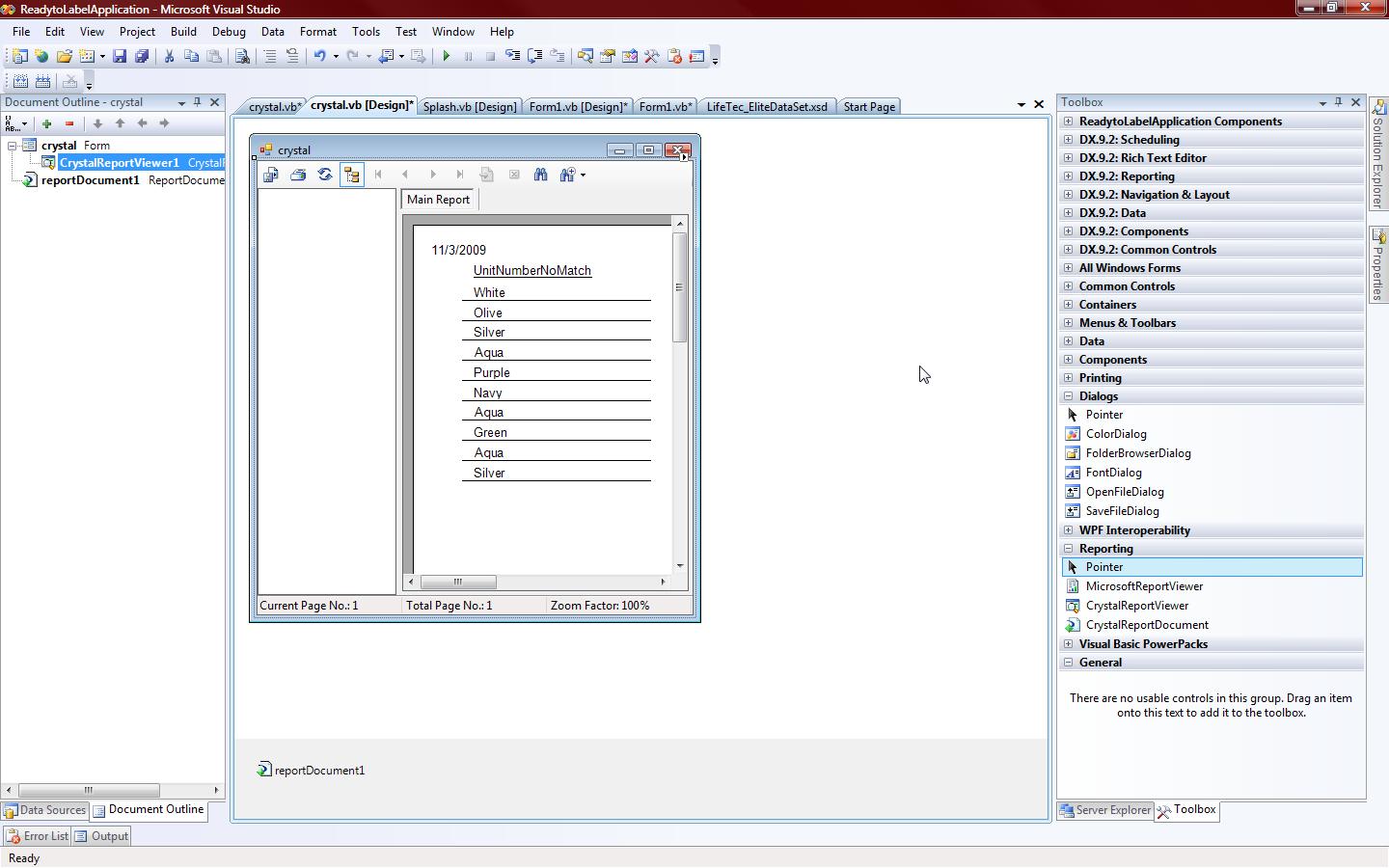

When  I browse to the crystal report that I have already created to add it into the CRViewer.. it does not show unit numbers.. it shows a list of colors.. see image..
by: CodeCruiserPosted on 2009-11-03 at 08:02:30ID: 25730286
That is down to your data and the design of the report to be honest. I think you are more expert in CR than me. But the actual question of how to show the report on button click has been answered! I dont mean you should accept my answer and stop the discussion. Are you sure you have correct data in the db table?
by: CodeJenniferPosted on 2009-11-03 at 08:04:40ID: 25730319
It's strange.. The report that I am pulling in is great... I can see it fine from the .rpt... nothing is wrong with the report.. I am sure of this.. It is when the I view the actual form it then only presents colors.
by: CodeCruiserPosted on 2009-11-03 at 08:07:05ID: 25730352
How do you populate the report? Using a dataset?
by: CodeJenniferPosted on 2009-11-03 at 08:17:11ID: 25730489
I tried using your code and I am having trouble there as well.. I was trying to stick to the original Q and just get the button to open the crystal report.. no luck.. I am going to keep trying to change the names. That must be the issue (naming)
As far as how did I populate the report - I used the CR Viewer and then browesed to a existing report. It is from the same database connection as the other datasets.
by: CodeCruiserPosted on 2009-11-03 at 08:20:17ID: 25730521
Jennifer,
Dont confuse report with reportviewer(how did I populate the report - I used the CR Viewer and then browesed to a existing report.). The report viewer simply displays your report. My question was about the actual report. Have you worked with crystal reports in .NET?
by: CodeJenniferPosted on 2009-11-03 at 08:21:59ID: 25730550
No I have not.. This is a first for me.. My report comes from my network.. What am I doing incorrectly?
by: CodeCruiserPosted on 2009-11-03 at 08:24:22ID: 25730578
There are multiple ways of populating data on a crystal report, as you might know. Try connecting to a dbserver in the report designer (use the server explorer on the left hand side). Drag and drop some fields on the report and try opening it.
