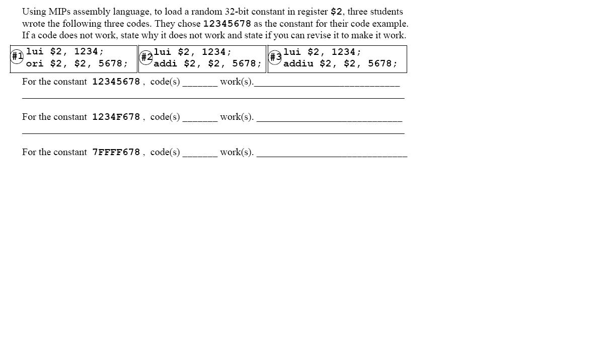

I got a question in my test which i got wrong, Please help me
Asked by: Kaustubh77
The question is as attached

by: Kaustubh77Posted on 2009-09-21 at 16:38:47ID: 25388675
For the first answer i guess , code #1 is true.. but i am confused abt the other 2
by: Infinity08Posted on 2009-09-22 at 01:42:33ID: 25390678
OR-ing the values together is the standard approach. The ori instruction zero-extends the immediate value, so (1) should indeed work without issues.
For the other two, there are two extra factors to take into account. Both the addi and addiu instructions sign-extend the immediate value. On top of that, the addi instruction can generate an overflow exception.
