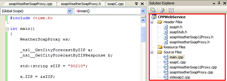

by: LordOfPortsPosted on 2009-06-19 at 14:31:28ID: 24670241
I have created a brief demo and it is not too easy to be honest, you will probably have to reference the documentation at http://www.cs.fsu.edu/~engelen/soapdoc2.html as you work through the project however here are the steps I have taken including the source code:
1. Run wsdl2h to generate the header file:
wsdl2h.exe -o weather.h http://ws.cdyne.com/WeatherWS/Weather.asmx?wsdl
2. Compile the generated header file weather.h with soapcpp2 (use -C option for client side files only, the -I path might be different on your end):
soapcpp2.exe -i -C -I"C:\gsoap\gsoap\import" weather.h
3. Create your C++ application project and include the generated .h and .cpp files (move them to your project directory if necessary), also include the stdsoap2.cpp file found in the gsoap directory.
4. Compile the project with the source code below and see if you get the same output.
I hope this is useful to you.
#include "soapWeatherSoapProxy.h"
#include "WeatherSoap.nsmap"
int main()
	WeatherSoapProxy ws;
	_ns1__GetCityForecastByZIP a;
	_ns1__GetCityForecastByZIPResponse b;
	// ZIP code of city for the weather forecast
	std::string sZIP = "90210";
	a.ZIP = &sZIP;
	if(ws.GetCityForecastByZIP(&a, &b) == SOAP_OK)
		std::cout << "City:\t" << *b.GetCityForecastByZIPResult->City << std::endl;
		std::cout << "Forecast Result:\t" << std::endl;
		ns1__ArrayOfForecast * aForecast = b.GetCityForecastByZIPResult->ForecastResult;
		std::vector<ns1__Forecast *> g = aForecast->Forecast;
		for(int i = 0; i < g.size(); i++) {
			std::cout << "Description:\t" << *g[i]->Desciption << std::endl;
		std::cout << "Response Text:\t" << *b.GetCityForecastByZIPResult->ResponseText << std::endl;
		std::cout << "State:\t" << *b.GetCityForecastByZIPResult->State << std::endl;
		std::cout << "Weather Station City:\t" << *b.GetCityForecastByZIPResult->WeatherStationCity << std::endl;
		std::cout << "Success:\t" << b.GetCityForecastByZIPResult->Success << std::endl;
	else {
		ws.soap_stream_fault(std::cerr);
	system("pause");
	return 0;
