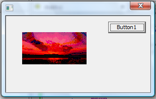

Function to load the bmp from resources:
HBITMAP LoadPicture(UINT nResID);
Draw in DC:
BOOL DrawPicture(HDC hDC, LPRECT lpRect, HBITMAP hBitmap);
If you will declare a static HBITMAP variable in the file with your window procedure:
HBITMAP s_hBitmap = NULL;
and load the bitmap before you create the dialog:
s_hBitmap = LoadPicture(IDB_BITMAP1);
will declare in the window procedure:
PAINTSTRUCT ps;
HDC hdc;
RECT rect;
and will add WM_PAINT handler:
case WM_PAINT:
   hdc = BeginPaint(hWnd, &ps);
   ::GetClientRect(hWnd, &rect);
   DrawPicture(hdc, &rect, s_hBitmap);
   EndPaint(hWnd, &ps);
   break;
You will see the image as a background of your window.

by: pgnatyukPosted on 2009-10-09 at 07:27:56ID: 25535314
So we need to load a bitmap from the application resources and draw it in a static control (or in a predefined position) in the dialog Win32 application?
Probably the answer is yes, because, seems like i have taken the code I posted and this code draw the image as a window background. So you can use the same DrawPicture function but use another rectangle in the second parameter.
Do you see this code:
   break;
you can change the rectange:
  // ::GetClientRect(hWnd, &rect);
   rect.left = 50;
   rect.top = 80;
   rect.right = rect.left + 128;
   rect.bottom = rect.top + 64;
   break;
I propose this way because I don't know where is your static control, what is its ID and so on. Actually, you need an image to be drawn in a predefined rectangle. It will be faster to draw it from the WM_PAINT handler then to add a child window.
But how you wish.
If if you have a static on the dialog and you know its Control ID or the window handle, you can take the DC of this controol and the control rectange and call DrawPicture with these parameters. Do you understand? Something like that:
HDC hWindowDC = ::GetWindowDC(hControlWnd);
::GetWindowRect(hControlWnd, &rect);
DrawPicture(hWindowDC, &rect, s_hBitmap);
But anyway you need to do it in the WM_PAINT handler.

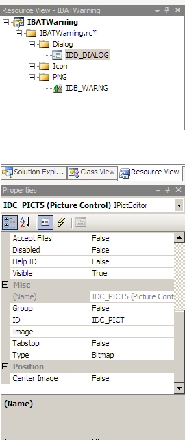

I sorta understand, I know its control, the ID is IDC_PICTURE, which is on the top left hand corner of the dialogue, right on the blue line/margins.
The picture resource is called IDB_BANG
So I put this in the WM_INITDIALOG case?
Would ::GetWindowDC work?  I am doing this in C using only pure Win32 APIs.  Isn't ::GetWindowDC a class thats only useable in C++?

by: jwnrbPosted on 2009-10-09 at 09:14:50ID: 25536376
Sorry for being so dumb, this project is my firs titme using Win32, if you can please give me more direction in what i need to do here.

Your code is a DLL. Just to show you how this BMP-loading work, I made an empty Win32 application in Visual studio and added empty main.c file. Then, I added a dailog resource with one button on it. Then added a bitmap. The code of my main.c file is attached. I attached also the screenshot.
It will be great if you can update your code yourself.
I don't have the file you are including in the posted code, it is a dll, etc. You are always welcome with more questions.
    • 18 KB
    screenshot from the dialog app

The new code does compile, however my picture did not show up.  The static control, IDC_PICT is where the bitmap control is.  where does that get populated with the bitmap i am loading whose resource is IDB_WARNG?

IDC_PICT is a static control? I'd delete it.
by: jwnrbPosted on 2009-10-09 at 13:36:45ID: 25538647
This is the resouece edtiuor.
    • 60 KB
    Resourece Editor
    • 24 KB
    God, third time is a charm, I swear!

by: jwnrbPosted on 2009-10-09 at 13:41:49ID: 25538701
Yes, IDC_PICT is my static control, the picture frame set to Bitmap type.  That is where I want the PNG file, IDB_WARNG to go.
