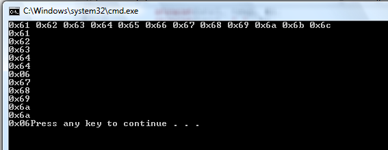

by: pgnatyukPosted on 2009-11-04 at 15:07:25ID: 25745087
attached code works in both directions

sorry. I see the error in the previous comment. It's too late to write a code, probably.
