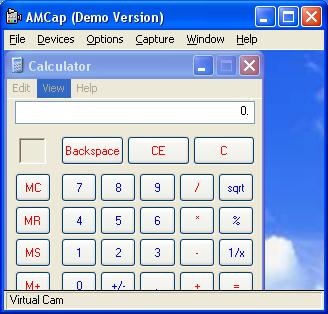

Capture a Window even a window is over
Asked by: CSecurity
Hi
I want to capture a window and even another program is over it, I want to capture that window's image.
Here is code I already have.
I get lpRect like this:
HWND hwnd = FindWindow("SciCalc", "Calculator");
      GetWindowRect(hwnd , &m_rScreen);
and I pass m_rScreen to capture Calculator's image.
But if I move notepad.exe over calc.exe, I get notepad's image.
Any ideas? Please advice...
Thanks from now

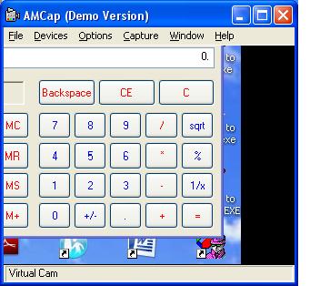

by: CSecurityPosted on 2009-10-30 at 04:19:28ID: 25701803
Not worked... Something is wrong again...
I moved calculator close to start menu and I got start menu Image within black borders...

by: CSecurityPosted on 2009-10-30 at 04:35:28ID: 25701880
Did this, and again captures somewhere else of window...

by: CSecurityPosted on 2009-10-30 at 08:38:10ID: 25704012
Wait...
Look at this code...
It streams image, but a little part of calculator if I move it to bottom of page close to Start Menu Button, I mean left close to 0 and bottom close to END.
What coordinates I should modify ONLY in THIS code to get it 100% working... Otherwise all thing in this code works...
I didn't understand what you mean.
There is a window with the top most style that covers the calculator?
by: CSecurityPosted on 2009-10-30 at 08:45:07ID: 25704093
The code I sent above streams image from start button if I move calculator close to start button. Only then I get some images otherwise I get BLACK image. If you modify that to capture correctly calculator window image, we are done
by: pgnatyukPosted on 2009-10-30 at 08:49:05ID: 25704134
:) I still don't understand.
With the code I posted I receive the calculator screenshot each time if this window is not covered by a topmost window such as TaskManager.
by: pgnatyukPosted on 2009-10-30 at 08:53:19ID: 25704173
Code from ID:25703971 works.
About which code you are talking?
by: CSecurityPosted on 2009-10-30 at 08:55:38ID: 25704208
Could you give me your email, I'll email you entire project

can you show me a broken image?
by: CSecurityPosted on 2009-10-30 at 09:18:17ID: 25704435
Here
by: CSecurityPosted on 2009-10-30 at 09:24:17ID: 25704508
By the way... It seems dead image. When I move mouse over buttons buttons become hover, but I can't see that in webcam, just when I move calculator window, I see some changes with bad quality of image
by: pgnatyukPosted on 2009-10-30 at 09:25:01ID: 25704517
Part of the calculator was on another monitor? :)
Can I propose to move the calculator window?
by: CSecurityPosted on 2009-10-30 at 09:25:16ID: 25704521
The image is taken when calculator was above top corner of screen and close to left corner but not reached it. I can see image just when calculator window is there and as I said it seems dead image... I have no any idea
by: pgnatyukPosted on 2009-10-30 at 09:26:09ID: 25704532
Because you copy the desktop. Not the calculator window. You copy what you see on the desktop. hSrcDC is the desktop.

by: CSecurityPosted on 2009-10-30 at 10:40:45ID: 25705225
Look what I get now

by: CSecurityPosted on 2009-10-30 at 10:58:19ID: 25705360
I finally solved size issue, now when I move notepad over calc, I see notepad... What was wrong for this problem?

by: pgnatyukPosted on 2009-10-30 at 11:00:34ID: 25705381
I've told you - you are taking images from your desktop. You receive exactly what you see on the screen. Because of that in my code I added SetForegroundWindow and other stuff - you will face these issues too.
by: pgnatyukPosted on 2009-10-30 at 11:01:43ID: 25705390
