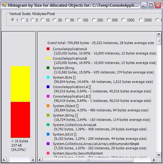

by: kpkpPosted on 2008-04-09 at 04:46:47ID: 21313825
The size of a class instance is not affeted by the number of methods in the class definition.
I thought I'd try and prove that using the CLR Profiler (http://www.microsoft.com/downloads/details.aspx?FamilyId=A362781C-3870-43BE-8926-862B40AA0CD0&displaylang=en)
Running the attached code creates 10, 000 instances of the two classes in the original question, so any difference in instance size should be obvious to see in the profiler results.
