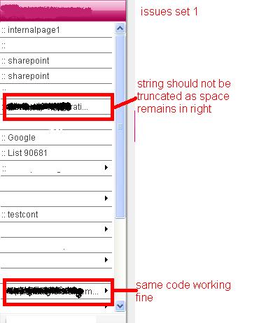

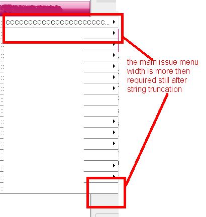

hi,
i'm facing a nightmare issue in our menus
the menu is inside a div of fixed width of 180px
the menuitem text is creating the problem
right now menuitem text is truncated on the basis of no of character but this is not the solution as 'CCCC' takes more space then 'iiii'
the menuitem css used is
font-family:Arial, helvetica,Geneva, sans-serif;
font-size:.75em;
now I'm changing the logic of truncation of menuitem text by using width of the string but issues are
1.i need to calculate width of the string according to the client machine
2. client's monitor resolution+installed fonts should be taken care of
so as everything is  not possible so I'm trying to make an approximate approach by using MeasureString of graphics object but not getting the required result
i'm trying following code but cant make it complete

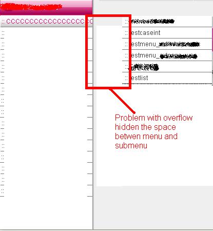

by: rakeshjaiminiPosted on 2009-08-18 at 03:55:40ID: 25121762
that wont work
i did this but the issue comes is the sub menus will open far away from its exact position also the black arrow image will not be shown in this case
the only solution is truncating the string with padding '...' in the end

by: rakeshjaiminiPosted on 2009-08-18 at 07:08:02ID: 25123328
it can be done in server side code
i have attached code of the same
but this code need to be corrected
it's not working fine as i'm getting point values from measurestring method where pixel is expected

by: rakeshjaiminiPosted on 2009-08-18 at 23:11:26ID: 25129966
Hi, abel first of all thanks for replying.i think some point are not clear to you from my question
 It is not (always) trivial to get the dpi, the screen size and the zoom size for a page, and getting the installed fonts is simply not featured through javascript or any other means, so that's off.
things i can get on server side
the client machine current resolution(it is sent to server from login page-application always opened as maximized window)
Zoom size-->we assume it to be on default setting
client browser's text size-->we assume it to be on default setting
fonts-->font-family:Arial, helvetica,Geneva, sans-serif; (all fonts belongs to sans serif and  i have checked it that character width remains same for whole sans serif family)
browser-only IE
OS-windows only
Not sure it's mentioned here already, but if the word-breaking algorithm comes into play if the string doesn't fit the maximum width of the target element, all browsers will act differently, which adds to the impossibility of solving this task.
about word breaking algorithm -i will do it by approximation that's not the problem
browser is IE only so that's not the problem
If breaking the string is not an option, then the only thing you can do is add overflow: hidden to the CSS class. But you said it doesn't help you. Why?
check attached screenshot
also the solution given by the sunithnair is nice but it wont work in my scenrio reason being menu is a third party control and id's are generated like 'navBarLeftMenu_navBarLeftMenu_p_SubNavBarItem5_menuAdmin' also the rendered text is inside td which dont have id
can't dig it more coz this is third party control :(
You say performance is an issue, but you want to solve it server side.
this is the tricky part in normal scenrio JS gives you performace boost but in our case its just opposite
also the reason i gave above that its an third party control.
please find my comments in below code it would be grateful if you can correct it
