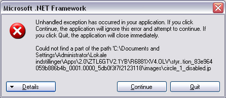

I get the following error when I try to run a published C# project. I know that the problem occurs because the program cannot find the images used in the project. If I copy the images to the specified location, then the program starts and no error occurs. The users of my program should just be able to install the program and not worry about copying images. Why are the images not copied along with the installation although the images is in the folder I install from?

I don't think thats the problem. I have added the images to the resources. The problem only occours with the images I try to load in code (see code example).
I think it's because I try to open the images from the harddisk. Maybe I should be opening them from the resources? I that case, how can I do that?

From the other class I assign the image to the picturebox by creating an object like this:
myPicturebox.Image = new ImageManagement().loadImageFromHarddisk(@"images\circle_1_disabled.jpg");

I found out myself. I loaded the images from resources like this:
Image temp = Properties.Resources.[imagetoload];
