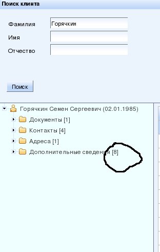

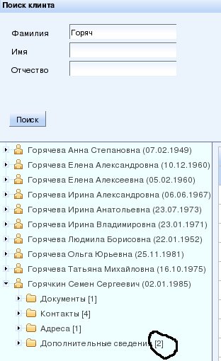

by: SemyonGPosted on 2009-10-27 at 07:54:15ID: 25673060
I tried this.
In result Number of parents is restricted maximum 100: it is good.
but number of fetched Childs for each parent is varies depending on number of fetched Parents.
See my example image files.
