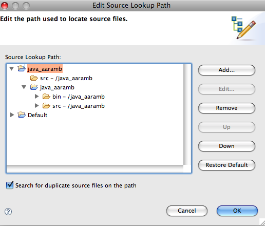

I did the lookup and added my source file. I have attached the screenshot of what i did, but still its not working. By using "step return"  i am only able to debug part of the code.

Try picking down at the source folder level OR at your top level package.  Just to see if it is an issue with the nested folder structure as you have project folder then another folder under it with same name as project then your bin / src folder.  IIRC, the source folder level is what you want as it will then walk the other folders based on your package structure.  If you set the path too high, then it won't find your classes as it will be looking for them in the root or for package structure from the root which doesn't exist.

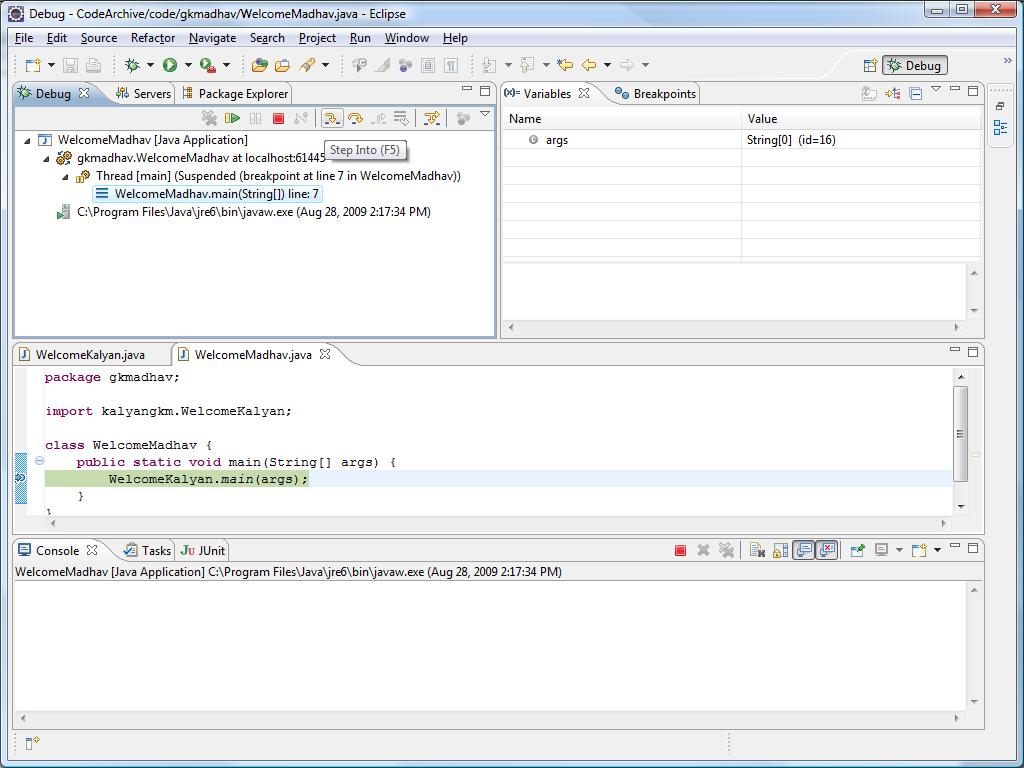

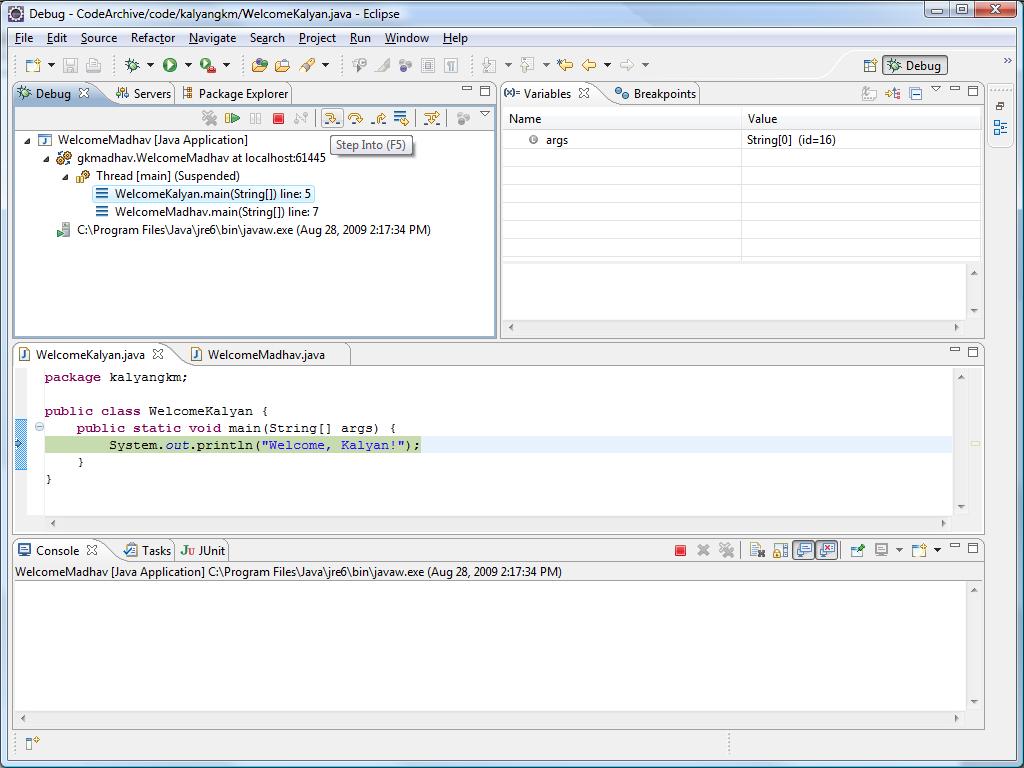

What worked for me was to put a breakpoint on this line of code:
WelcomeKalyan.main(args);

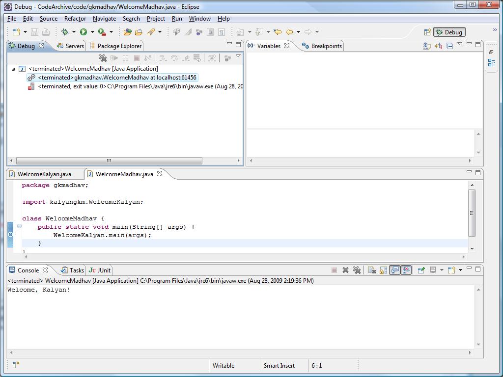

Then Debug the WelcomeMadhav using Debug As | Java Application.  The screen in image 'step 1' below comes up, at which point I click 'step into'.  Then the screen in image 'step 2' comes up allowing me to debug the code in WelcomeKalyan class (as you can see it is working).  From here, I can 'step to return' which will put me back into WelcomeMadhav.  When at the bottom of WelcomeMadhav or done debugging, I hit 'resume' as shown in image 'success'.

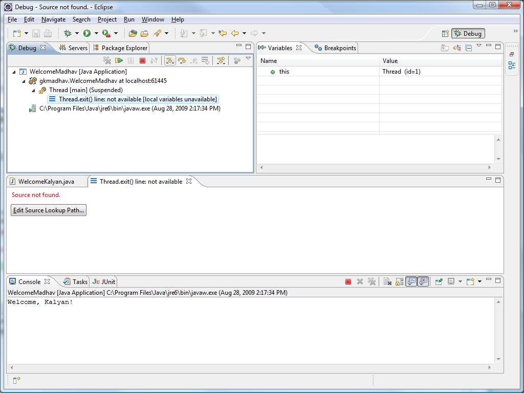

Now regarding the last sentence above, if I don't hit resume when exiting my class but instead hit 'step over' or 'step into', the debugger thinks I want to debug the Thread.exit() method.  This is where I get the source not found message as shown in image 'error'.
This is not a problem and you don't need to debug that, so you should be fine.  If for some reason this is still not functioning correctly, I would try a clean installation of MyEclipse and then re-import your projects or switch to normal Eclipse where I did my testing.
