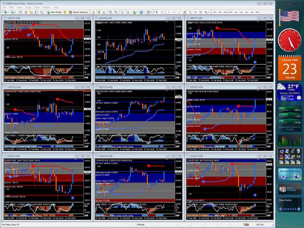

I am going to take a screenshot of my desktop , I simply have a Timage on my form which I copy the desktop area to it using the attached code , it works fine , but vista side bar is not captured in the image ! and desktop behind it is captured , look at the pictures , one is captured by snagit , other one which doesnt have side bar is captured by my program , how can I solve this problem ?
    • 200 KB
    captured by snagit

SnagIt doesn't capture the desktop, it captures the entire screen, that's why it includes the sidebar.
(at least from what I read at http://www.techsmith.com/snagit/featureslist.asp)
To do the same thing from your program, you would minimize all windows except the sidebar and then capture the entire screen. I don't think users would like auto-minimizing windows! :)

alkisg : my program captures the entire screen too , anything on screen , except sidebar of vista !
ciuly : my code captures all windows on desktop , if you look at the sent image , you can see a program is running and it is captured , my only issue is with vista side bar , I dont have any problems in XP. seems somehow this sidebar is different. may be I should use another method to capture screen.
