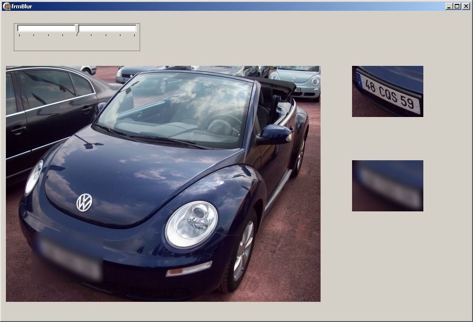

by: Geert_GruwezPosted on 2009-08-02 at 18:33:57ID: 25001453
first of all you'll need a unit to blur something:
http://www.delphi3000.com/articles/article_2205.asp?SK=
then you need to select the portion you want to blur :
i selected the jpeg into image1.Picture
and trackbar is to set blur of portion

    {record the location of the bitmap data:}
    for Row := 0 to theBitmap.Height - 1 do
      theRows[Row] := theBitmap.Scanline[Row];
    {blur each row:}
    P := AllocMem(theBitmap.Width * SizeOf(TRGBTriple));
      BlurRow(Slice(theRows[Row]^, theBitmap.Width), K, P);
    {now blur each column}
    ReAllocMem(P, theBitmap.Height * SizeOf(TRGBTriple));
    for Col := 0 to theBitmap.Width - 1 do
    begin
      {first read the column into a TRow:}
        ACol[Row] := theRows[Row][Col];
      BlurRow(Slice(ACol^, theBitmap.Height), K, P);
      {now put that row, um, column back into the data:}
        theRows[Row][Col] := ACol[Row];
    end;
    FreeMem(theRows);
    FreeMem(ACol);
    ReAllocMem(P, 0);
  end;
end.

by: Geert_GruwezPosted on 2009-08-02 at 18:35:12ID: 25001460
oh yeah, in case you wondered ...
use the mouse to select the portion you want to blur
by: LLorenzoPosted on 2009-09-08 at 03:37:23ID: 25280358
Hello Again
Thanks for your example, it works fine
moreover, can you explain me how to select the area to blur
using two clicks for each side of the plate ...
Thanks in advance
by: Geert_GruwezPosted on 2009-09-08 at 04:31:45ID: 25280689
currently it's a drag operation
