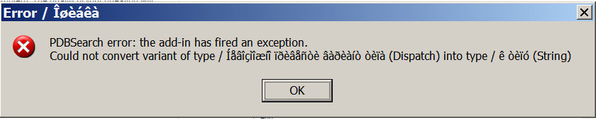

Could not convert variant of type / blahdieblahdieblah (Dispatch) into type / blahdieblahd string
Asked by: PeterdeB
Hi Folks,
I have an error message which causes me a lof of psychological mumbo jumbo. Now I attached the procedure causing this eror but if you need more info, the complete unit or project even with the components please let me know.
My addin searches an entire excel 2k3 workbook for a string, this goes without any errors unless the workbook contains too much data? I'm not sure about this, some workbooks cause no problems but this one does.
If you need more info please let me know!
Dweeep
Ps I attached a screenshot from the error I get from within excel 2k3

by: epasquierPosted on 2009-11-03 at 07:39:36ID: 25729983
I have some correction you might want to check :
when you access your cells, you use
hostapp.Cells.Item[r,c]
Is it not Sheet.Cells.... ?
And a question I already asked in a previous post : why do you need IEdt findcontrol to be executed each loop ?
to search only in the first column :
Sheet.Cells.SpecialCells(xlCellTypeLastCell,EmptyParam).Activate;
IEdt := FindControl(EdtSearchTag, axpEdit) as IaxpEdit;
for i:=1 to hostapp.ActiveCell.Row do
 begin
  if pos(iedt.Text,Sheet.Cells.Item[i,1]) > 0 then
            frmSearch.mmo1.Lines.Add(Trim(Sheet.Cells.Item[r,c].Value));
 end;

by: PeterdeBPosted on 2009-11-03 at 14:13:06ID: 25734399
epasquier guess what? I just implemented your code and it is as if you boosted the performance beyond compare!
Apart from that I am unable to reproduce the error that caused me to start this topic!
I will consider this one solved, thanks!
