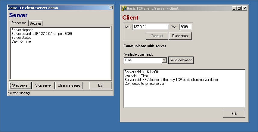

by: MrMuttleyPosted on 2008-05-05 at 05:49:19ID: 21499604
I have downloaded your demos a copuple of day ago while searching on this website, but i didn't manage to get them to work with what i have. Are the demos compatible with Indy 10 and Delphi 2006?
Thanks.
by: BdLmPosted on 2008-05-05 at 07:00:10ID: 21500069
is your problem using Indey 10 with Delphi 2006 or you need a simple server program acc. your text above?
Did you get the Indy components in your IDE?
by: BdLmPosted on 2008-05-05 at 07:17:45ID: 21500179
here is a indy 9 demo, function simillar to your request, I hope there is no chnage in these basic functions between indey 9 and 10 , btw. indy 10 still under development?
I added a few lines of code to highlight where to put further modifications on this code

 This basic demo shows the following:
 (1) How to receive and send Strings and Integers to a remote client
 (2) How to disconnect a single remote client
 (3) Basic protocol conversation between server and client, all contained in the OnExecute event
