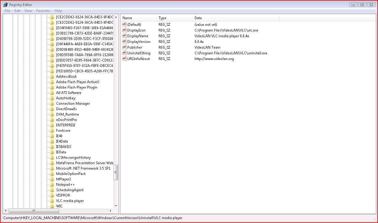

I would like to try a different perspective if I may.
You mentioned that a machine, in the log, shows NO uninstall.  But you say that the machine has the file at:
C:\Program Files\VideoLAN\VLC
Is the actual path to the uninstall on this machine
C:\Program Files\VideoLAN\VLC\uninstall.exe     ?
If so, please search this paticular machines registry for this string.
Basically, I am trying to find where under hklm is the Uninstallstring found.
If you could find the registry path to the key that holds this path on this machine I may be able to help.
by: JeffPartonPosted on 2009-11-18 at 17:23:49ID: 25856828
If you don't know how to search the registry to find where this string is found, let me know.
by: JeffPartonPosted on 2009-11-18 at 17:27:33ID: 25856842
Most likely it will be found somewhere in
hkey_local_machine\SOFTWARE\Microsoft\Windows\CurrentVersion\Uninstall\
In there you should find a folder that correlates to the software name.
I need to know this subkey.  Inside this subkey, you should find a key named "UninstallString" in the right pane.  The value for that key should be the "path to the uninstall.exe" for the software.
by: bsharathPosted on 2009-11-18 at 19:48:00ID: 25857358
Jeff attached is the registry image.
Please see the bottom for the path you mentioned.
by: JeffPartonPosted on 2009-11-19 at 21:22:43ID: 25867809

by: bsharathPosted on 2009-11-20 at 12:04:31ID: 25873984
Still does not uninstall
But when i run this manually it uninstalls perfectly
C:\Program Files\VideoLAN\VLC\uninstall.exe /S /NCRC
by: bsharathPosted on 2009-11-20 at 12:07:37ID: 25874018
yes thats exactly what i want
Can we try this path. If not found then search the other parts.
By default its this path. say 10 out of 100 install it in some other paths

by: bsharathPosted on 2009-11-20 at 12:40:49ID: 25874319
still does not work
by: JeffPartonPosted on 2009-11-20 at 12:53:27ID: 25874453
Out of curiosity.
Add the line
msgbox "C:\Program Files\VideoLAN\VLC\uninstall.exe /S /NCRC" & " - Compared to - " & UninstallStringToUse
AFTER the line that reads
If StringExists = 1 then
Do they match??
by: bsharathPosted on 2009-11-20 at 12:55:57ID: 25874472
I get this
C:\Program Files\VideoLAN\VLC\uninstall.exe /S /NCRC - Compared to -
OK
by: bsharathPosted on 2009-11-20 at 12:59:50ID: 25874503
When i run this line manually it does uninstall
by: JeffPartonPosted on 2009-11-20 at 13:04:58ID: 25874532
One more test please.
Change
To
msgbox "C:\Program Files\VideoLAN\VLC\uninstall.exe /S /NCRC" & " - Compared to - " & """" & UninstallStringToUse & """"
by: JeffPartonPosted on 2009-11-20 at 13:26:13ID: 25874695
If you could please.  On about line 47
UninstallStringToUse = Cstr(strValue2)
Change this to
UninstallStringToUse = """" & strValue2 & """"
I am curious if this runs.  For some reason it is not seeing the variable correctly.
by: JeffPartonPosted on 2009-11-20 at 13:51:52ID: 25874875
Solved it.  I actually installed the silly program for testing.  It works on my machine with the below script.
It does NOT do the Default thing.  This version finds it wherever it is and uninstalls silently.  I test on multiple local drive letters and all worked.
