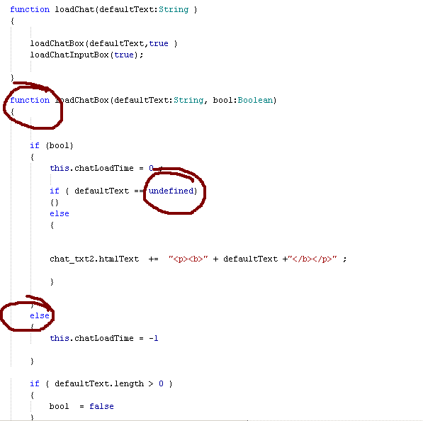

I am trying to highlight syntaxes using actionscript 3.0 . Are there helpful resources available, that can guide me through the process.

by: VigusPosted on 2009-11-06 at 05:42:14ID: 25758940
No, the demo is highlighting for finding the word.
Need something as follow in the image ( circled with red )

by: VigusPosted on 2009-11-06 at 06:41:47ID: 25759455
well, I just viewed the knowledge base, that have some threads related to creating an  editor ( that may show intellisense). It talks something about regex. I think that's more suitable.
@ChristoferDutz - Using finding methods, to create syntax highlighter function , the actionscript would just halt the player. As i would need to refresh it every second ( or even millissecond ). Don't you think so ?
Can anyone help me, how regex can be used in better way for actionscript. My main concern is about refreshing it every moment, that may hang the player. So i need a solution that takes care of this concern.
by: TanLiHaoPosted on 2009-11-16 at 18:22:42ID: 25836334
Hello Vigus. If you are talking talking about having textfields or any other text containers, then actually the right way to do it is to change the colour of the text which needs to be highlighted, this way the text will be automatically "refreshed" by the Flash Player itself and you do not have to worry about every second or every millisecond issue. Just change the colour accordingly and the text is highlighted according to the syntax.
Yes you can use regular expressions to search for the words you actually want to highlight, then you replace the words with a format and change the colour. You might want to use htmlText or generate new text fields with a different colour.
If you actually have a source file, please upload it to a file sharing site and I can help you from there. If you do not actually have a source yet, please tell me the exact details you want. At least you should try to show me how you want the whole thing to look like.
