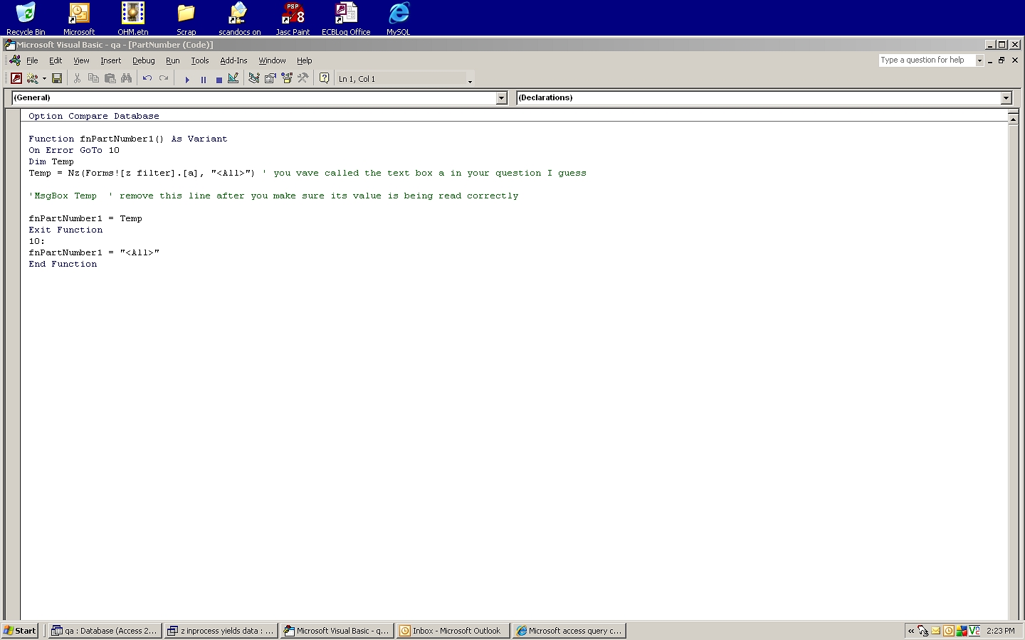

Function fnCustName1() As Variant
On Error GoTo 10
Dim Temp
Temp=Nz(Forms!MyFormName!txtCustName1,"<All>") ' you vave called the text box a in your question I guess
Msgbox Temp  ' remove this line after you make sure its value is being read correctly
fnCustName1=Temp
ExitFunction
fnCustName1="<All>"
End Function

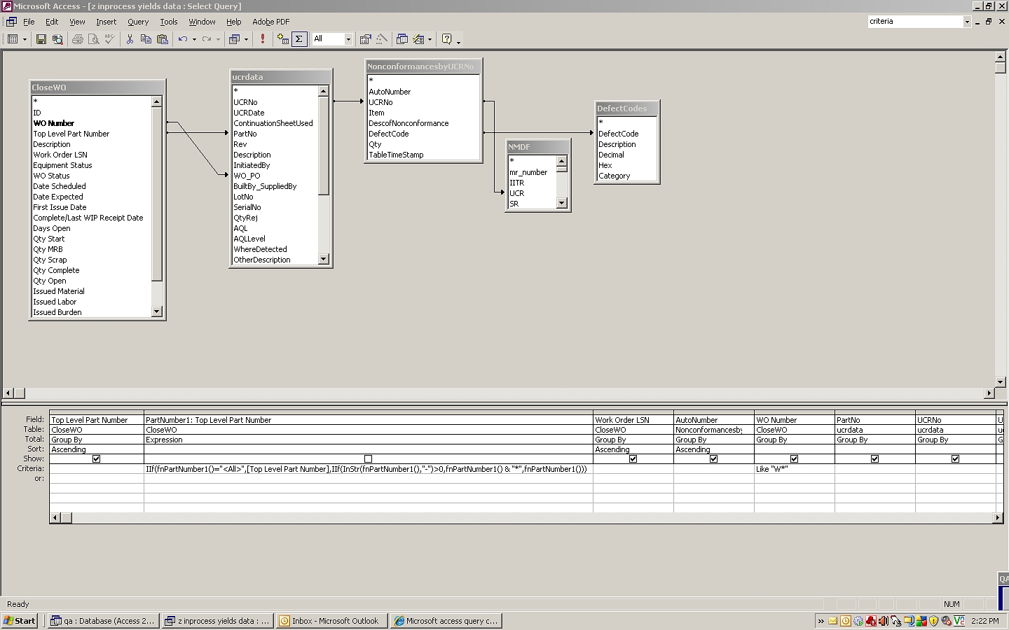

Now things don't work at all.  I have attached screen shots of the code and the query with the criteria
by: eghtebasPosted on 2009-08-07 at 11:31:50ID: 25045665
You are missing Like at the start of the criteria. There are two options, try them both.

Here is my field: PartNumber1: Top Level Part Number
Here is the criteria below this field:
Like IIf(fnPartNumber1()="<All>",[Top Level Part Number],IIf(InStr(fnPartNumber1(),"-")>0,fnPartNumber1() & "*",fnPartNumber1()))
I enter the following part number in my form "10A0988-A01" and I get the results I am looking for.  However, when I type in "10A0988", I get no results........

Like IIf(fnPartNumber1()="<All>",[Top Level Part Number],IIf(Left(fnPartNumber1(),7),fnPartNumber1() & "*",fnPartNumber1()))
This seems to be working.........
