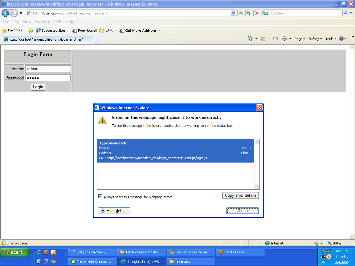

by: designersxPosted on 2009-08-04 at 06:07:03ID: 25013218
so to prevent the error of innerHTML, i am using the below code, in this it is saying the type mismatch error at line f.replaceChild(response,oldChild);

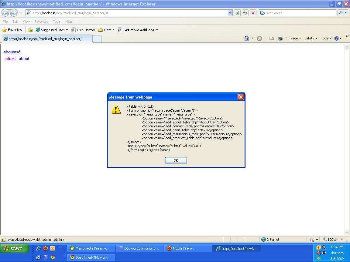

Hube02: ur post really seems to be helpful. ok tell me sir is the below snapshot output acceptable. because it is giving run time error in IE. pleas have a look at that.

this is my another way of how i am doing code in my login.js file. this is the 2nd method. in this this error comes as below in the snapshot.
by: Hube02Posted on 2009-08-06 at 09:31:21ID: 25035337
I don't see anything wrong with the first image and I don't see anything that stands out as being wrong in the files that you attached.
I don't understand what error you are talking about in the last image.
by: designersxPosted on 2009-08-06 at 09:44:35ID: 25035471
oh thanks god you are here. ok let me explain you your questions. really thanks , now we will come ona conclusion.
sir yes there is nothing wrong with that snapshot. you told me that if i do this way that would work
data = '<table'><tr><td>This should work</td></tr></table>';
document.getElementById('insertTableHere').innerHTML = data;
this should work  in ur previous post.
so i wanted to ask you that my response is coming this way and still the error comes. so i was asking you is this the format of response that is coming is right??
that means you have checked my files. thanks for that sir. i wanted to ask you that please look the js files both js files.and tell me which js code i should use so that it runs on all the browsers.??  i strongly feel that there is a need to change the format of php files means insert/add the tr table tags so that the code runs in all browsers. i wanted you to check that.
the problem is that you can see that there are 5 dropdowns showing instead of 1. if i use innerhtml no matter how many times i click on the link admin, dropdown will be shown only 1 time. this is the problem. dropdown will be shown to me the number of times i click on the dropdown.
by: designersxPosted on 2009-08-06 at 09:47:47ID: 25035508
the form is getting submitted and the page reloaded and that is what IE did not like. his is why i am facing the problem.
