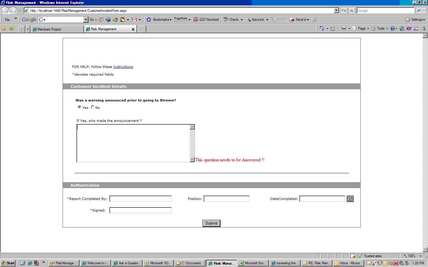

Hello,
Iam a novice in Javascript and would like to achieve the follwing with your help.
I have a dynamic form which generates questions and answers. A question may or may not have a subquestion.
Depending on the answer to the main question I would display the subquestion.
Now the problem Iam facing is the following
Lets take a question and answer sample
1)   Do you want to display the Secondary Question   (This would be the Primary Question)
          RadioButtonList -> YES  NO                                (This would be the Primary Answer)
            ( Required field Validator Control on the Primary answer which tells the user that u need to answer this question )
Now based on the answer to the Primary Question , If the answer is YES then a new row would display liek below
2) This is the Secondary Question (Secondary Question)
      This is the Secondary Answer ( Secondary Answer )
         ( Required field Validator Control on the Secondary answer which tells the user that u need to answer this Secondary question )
***** I have attached the HTML code snippet tooo for reference ************
Now when the user asnwers the Primary question with a YES then the row ID of the row which contains the secondary question and answer is passed to a javascript function which then makes the display style in line and the user then sees the secondary row with the secondary question and answer.
***** I have attached the Javsscript code snippet tooo for reference ************
Now the problem is since this a dynamic control , I wouldnt know till runtime if the secondary answer is required or not. In case where the secondary answer is required,  this is what happens.
Say suppose the user answers by clicking on the NO of Primary answer radio button list. Since the user clicked a NO the secondary question would not be shown (style = display:none for the row)
but when the user presses the submit button  nothing happens cus althouhg the secondary question answer row is invisible to the user , it is still there on the html page and the required field validator is still expecting the answer to the secondary question.
Hence , since in the javascript which receieves the ID of the secondary row , I would like to traverse this row and find the required field validator and disable it so that it wouldnt work when the row is invisible so that the user can submit the form.
I would suggest if you could copy paste the html code and the javascript  in an aspx or html form to get a better understanding.
So basically i would need to traverse a row for its elements given the row ID , find the required field validator and disable it when the row is not visible.
Can this be done ??
Hoping for some help ASAP.
THanks in advance.
Ashwin

Image which shows what is being described in the question
