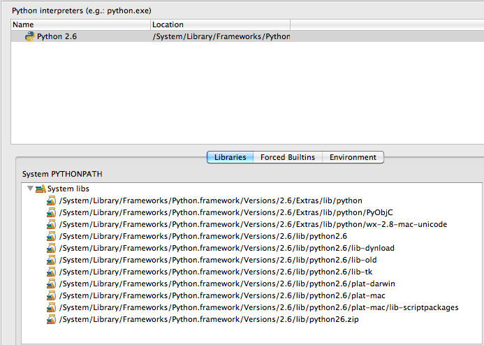

I have successfully installed PyQt4 and PyDev. When I try and run code that uses PyQt I get unresolved import errors on the PyWt stuff. The code works fine if I run it with Idle, so I guess there is a configuration problem, but I'm blowed if I can resolve it. Can anyone help? I've attached a screenshot of the PyDev preferences.

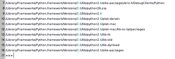

Thanks for the reply. I've attached a screenshot showing the output. There is a PyQt4 folder in site-packages, so I tried adding that to PythonPath, but it made no difference. How do I change sys.path and should I add the dir in site-packages?

Try as I may I can't kick this thing into life. If I print out the sys.path in Eric4 then it looks exactly the same as when printed out with PyDev in Eclipse. Eric works PyDev doesn't. The PyQt4 folder is the same folder hierarchy as Python, but it doesn't pick it up when it does the scan. So I'm stuck and destined to use Eric unless someone knows how to fix this.

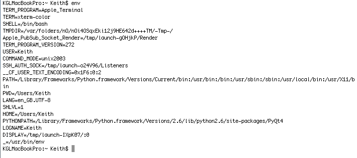

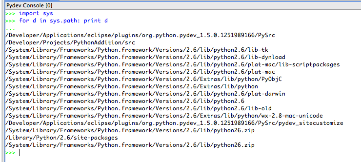

I am using a Mac, so set PYTHONPATH up in the Bash profile. The first screenshot shows the output from the env command. I then restarted the system and went in to the PyDev setup, removed the interpreter path and reset everything. There are screenshots of the preferences page and a dump of sys.path. The problem is still there. Maybe the PyQt4 path is wrong, but thats the only one pointing at .so files that I can find. Anyway thanks for all your effort so far. Can you think of anything else - at the moment I am suspecting a bug of some sort.

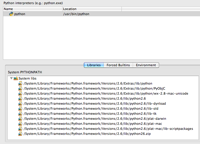

1st, try to edit PyDev prefs (shown at Screen-shot-2009-10-11-at-09.32..png)
and type the above path to python in (instead of /usr/bin/python).

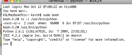

Also show us 'ls -l /us/bin/python' and '/usr/bin/python' commands output.
Let see if that helps.
by: easiwriter45Posted on 2009-10-11 at 23:11:49ID: 25548864
Still no change. I've attached the output.
