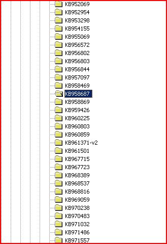

by: bsharathPosted on 2009-10-25 at 19:33:05ID: 25659434
by: bsharathPosted on 2009-10-25 at 19:55:31ID: 25659489
Rob i just tested on a win 2003 machine. First i tried installing on a machine where the patch was available. I got its available. Then removed it restarted the machine and tried and i got this message
\\indphos\InterChk\Ms_Patch\Win2003-32_bit\WindowsServer2003-KB958644-x86-ENU.exe -q is already installed on DEVCS161.
Installing patch \\indphos\InterChk\Ms_Patch\Win2003-32_bit\WindowsServer2003-KB958644-x86-ENU.exe -q
Installation successful on DEVCS161
But cannot see in Add/Remove programs
How many ever times i run i get as its installing and its installed successful

But the log even when the patch is available i get this
Installation successful on IN-1
Instead i need to get as available
by: bsharathPosted on 2009-10-25 at 22:17:03ID: 25659764
Still does not install if patch not there but the log shows as installed
by: RobSampsonPosted on 2009-10-25 at 22:22:18ID: 25659788
Have you got
strPatchNumber = "931906"
correct?  If you go to HKLM\SOFTWARE\Microsoft\Windows\CurrentVersion\Uninstall
and search for the number you use as strPatchNumber, that needs to be found in the registry. That is how it searches for the patch.
Regards,
Rob.
by: bsharathPosted on 2009-10-25 at 22:27:47ID: 25659810
I have this patch "958644"
Attached screenshot shows its not having an entry in the registry
by: RobSampsonPosted on 2009-10-25 at 22:35:50ID: 25659834
So the above screenshot is from Add / Remove programs?  I'll have to use another method instead of the registry to see if it already exists then.  I'll try to have that working tomorrow.
Regards,
Rob.
by: bsharathPosted on 2009-10-25 at 22:37:22ID: 25659839
No screenshot is from Registry...
Ok Thanks
by: RobSampsonPosted on 2009-10-25 at 22:57:22ID: 25659891
Oh, so it *is* in the registry, under the key I mentioned?  That means that the script should be able to detect that it has been installed. Anyway, I'll test it again tomorrow.
Rob.
by: bsharathPosted on 2009-10-25 at 22:59:50ID: 25659899
Yes its the location
by: bsharathPosted on 2009-10-26 at 06:43:36ID: 25662127
