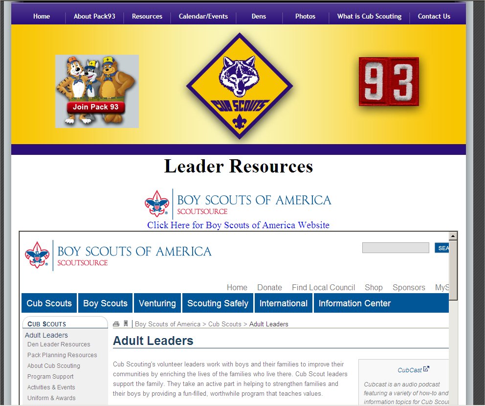

by: mplungjanPosted on 2009-10-30 at 00:33:29ID: 25700737

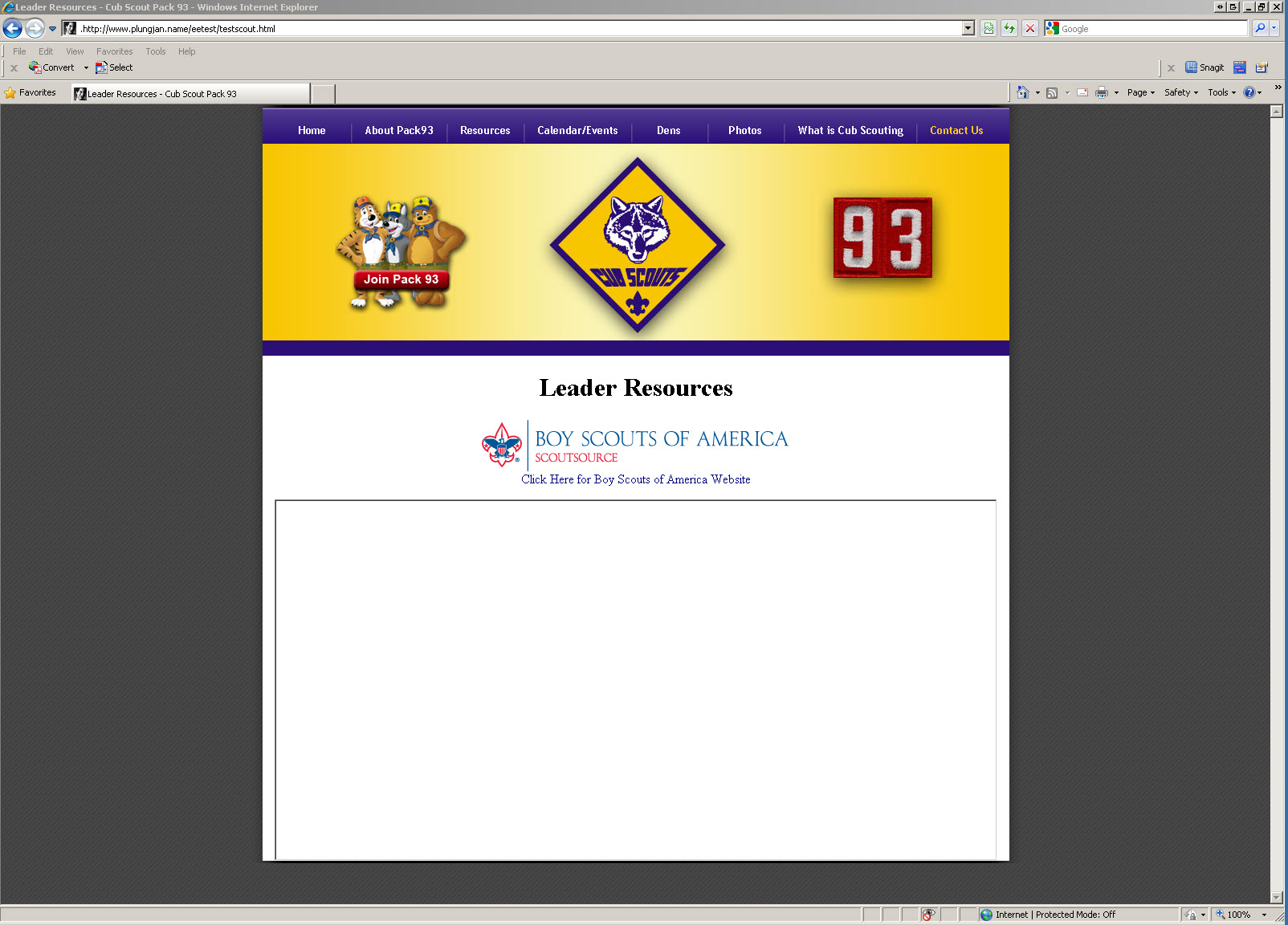

Here is what I get when I click your link.  Sorry for the delay.  Cleared cache and tried the other solutions.  All result the same see attached photo

Also the link that you sent on your test site creates dbl scrollbars in Opera, Safari, and Firefox.

Also cleared cache.  The machines that are having trouble is a Vista machine with IE7 and a Win 7 machine with IE 8.  I have changed the iframe options under the misc. section of the security settings on the box that I just sent you the screen capture on.  It was one of the first things I checked.   I may scrap the iframe if it ends up being an option on the workstation that needs to be fixed.
