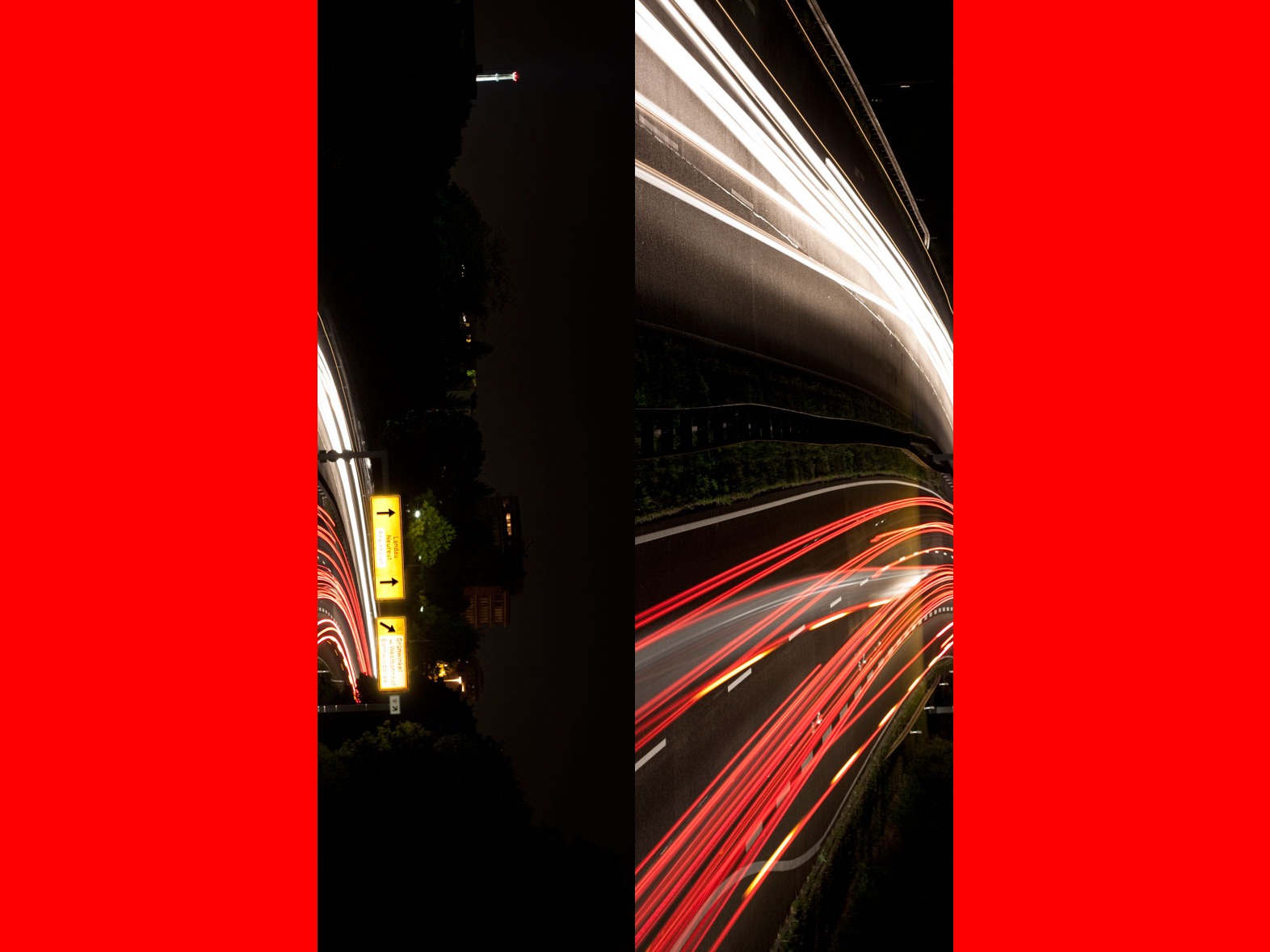

I want to convert an Image from vertical format into horizontal. How can I do that? I tried it using RMagick with some quite funny results. You can find it in the Attachment to this posting.
As you can see, the position of the vertical image is quite in the center of the "large horizontal" image, but the image looks quite funny. How what do I have to change im my code?

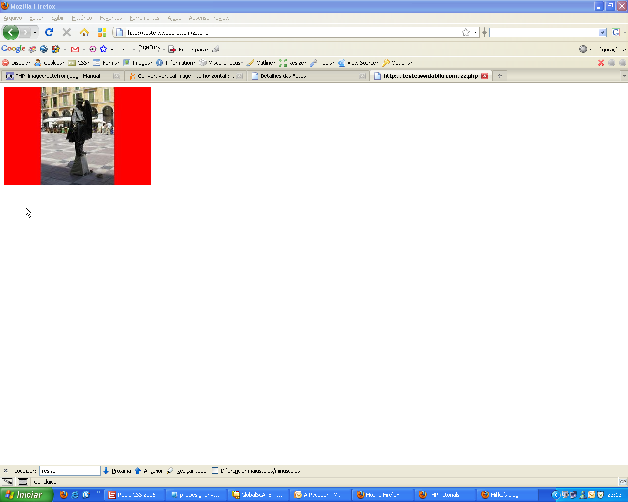

by: joaochagasPosted on 2009-09-14 at 15:15:04ID: 25329839
Hi llord, I put a script in snippet code, write in php. I use some functions of gd library and others from imagick.
Is better you verify first if your server have installed imagick extension, if not the script don't work, and the solution is contact the support for they install imagick.
In my server work very well, like you can see in attach image.
Good luck.
Regards, JC
