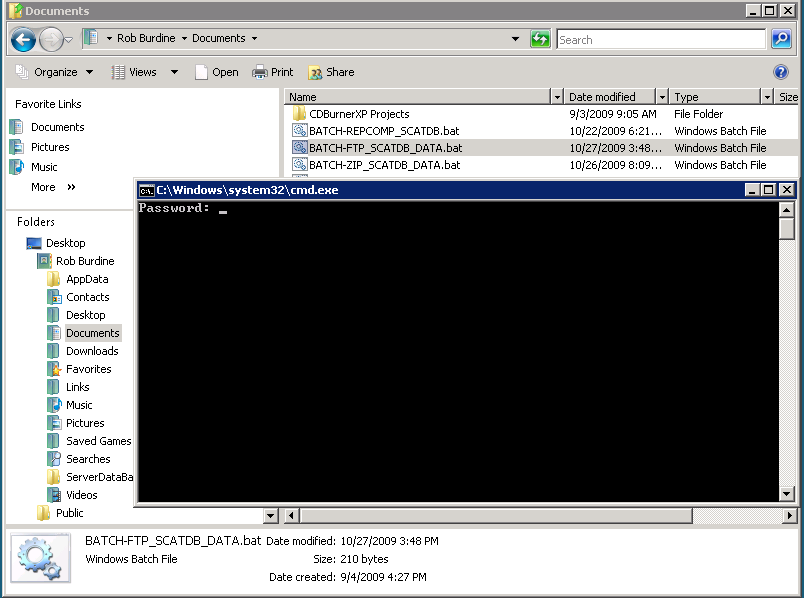

A ha I think I am on to something. Finally can you help me with this. Before I was getting the prompt below when I simply clicked on the batch file and get the cmd.exe with the word password in it and a non-blinking cursor.
I typed in my user password and the black screen went away and dissapeared. The file got  uploaded to the FTP site but it had a file size of Zero. So what does that mean? That I have to put some kind of extra code that puts in my user login password for Windows 2008 Server in that little command window you see below.
by: QlemoPosted on 2009-10-28 at 11:01:10ID: 25686263

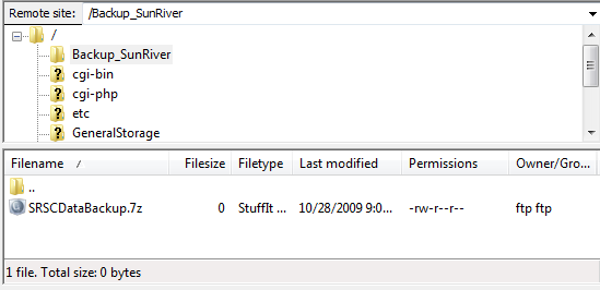

FTP creates a file of zero size on copy (get or put) if the source does not exist.
About the passowrd, you can try to combine user and password on one line - depending on the remote FTP server, this works.

put "C:\Users\Public\ServerDataBackup\SRSCDataBackup.7z"
200 PORT command successful. Consider using PASV.
425 Failed to establish connection.
ftp>
Is this the culprit? I do not know what PASV means?
