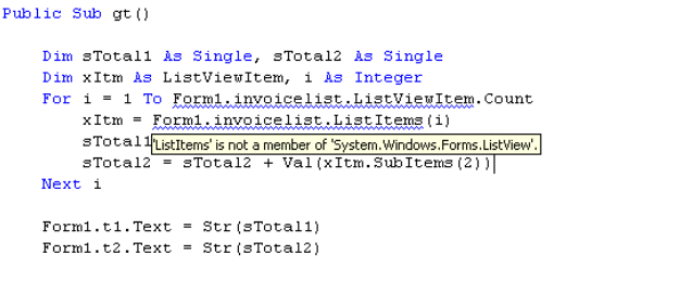

by: awolarczukPosted on 2009-09-19 at 01:55:27ID: 25372130
Thanks mate this looks like the code for VB6  i am using vb 2008 , i have taken the code for the update_totals and tested it and having some issues
(i have already got a listview on my page and i am just needing to get the totals from this)
I have attached the code as well as a image for this error
thanks for your help so far it olooks like i am almost there thanks to you
Module gtotal
    Public Sub gt()
        Dim sTotal1 As Single, sTotal2 As Single
        Dim xItm As ListViewItem, i As Integer
        For i = 1 To Form1.invoicelist.ListViewItem.Count
            xItm = Form1.invoicelist.ListItems(i)
            sTotal1 = sTotal1 + Val(xItm.SubItems(1))
            sTotal2 = sTotal2 + Val(xItm.SubItems(2))
        Next i
        Form1.t1.Text = Str(sTotal1)
        Form1.t2.Text = Str(sTotal2)
    End Sub
End Module
by: robberbaronPosted on 2009-09-20 at 21:44:19ID: 25380380
it's confusing but this is the vb5/6 TA.
i think for vb2008, the property is just  .Items
http://msdn.microsoft.com/en-us/library/system.windows.forms.listview.listviewitemcollection.aspx
ie Form1.invoicelist.items(i)
refer the example
http://msdn.microsoft.com/en-us/library/system.windows.forms.listview.selectedindexcollection.aspx
price += Double.Parse(Me.ListView1.Items(index).SubItems(1).Text)
