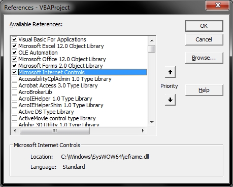

I'm running Windows 7 and was able to get that code working in an Excel 2007 UserForm.
Below is a picture of the reference as it appears in Excel:
by: ahammarPosted on 2009-09-07 at 10:05:18ID: 25276251
Ok...I tried it in Excel 2007.  My references are exactly the same as the pic you uploaded.
